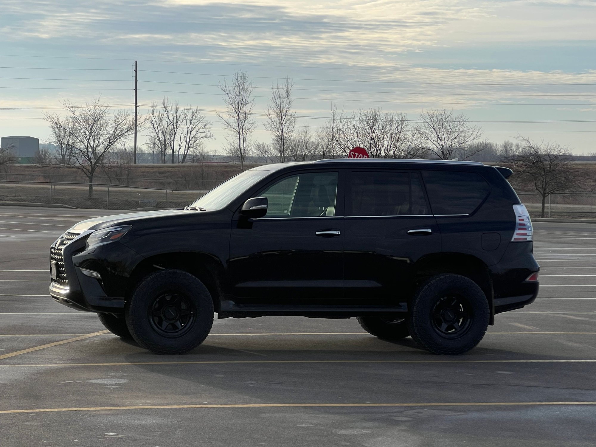

If ya'll are considering getting your GX lifted, I can't recommend Cody Crafted out of Alvarado, TX (30 minutes from Dallas/Ft. Worth) enough. After watching his GX videos on Youtube, I called him and we worked out a killer package for my wife's 2020. We went with the full Dobinson's IMS kit with Methods and Wildpeak AT4s. It looks insane and drives with the same manners and only slightly rougher than factory. Cody is a true professional and we liked him so much we drove all the way down from Iowa for the install. The finished product is better than we could've hoped for, and Cody Crafted truly "builds cool *****!".

Nice! What size tires are you running? Any rubbing?

Thank you! We went with the 275/70/17 and there is absolutely no rubbing. The only issue we had was not enough room for the new wheel/spare underneath. I got a set of Dr. KDSS sway bar spacers and installed them and problem was solved.

Cool! What offset are the wheels?

I couldn't remember, so I checked the invoice.
Method 708 Gloss black
17x8.5- 0 offset

Looking great, nice and clean
