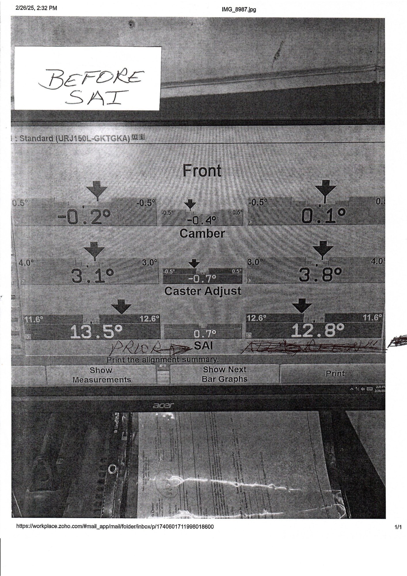

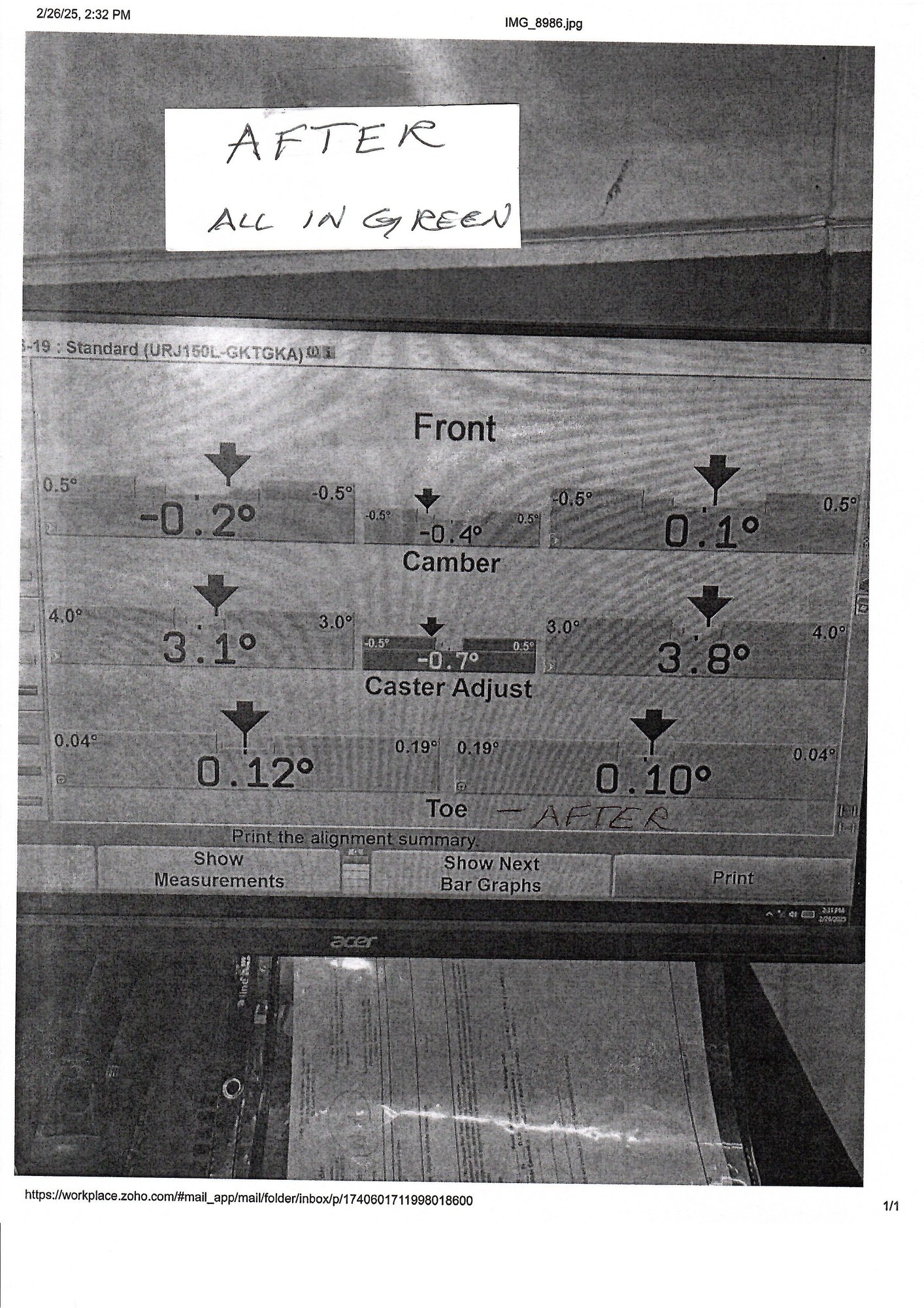

I did get alignment numbers. The tech took pics and sent to manager's email. So the pictures may be a bit hard to read. The "Before" was the preliminary measurements. The "Before SAI" shows SAI measurements before adjustment. The "After" shows after adjustment measurements, and all these numbers are in "green", meaning in spec. There was no "After SAI" alignment numbers page, as evidently their printer went down. Tire dealer said since all the "after" numbers were in spec, this makes the SAI measurements all in spec; that is, between 11.6 and 12.6 degrees. Any thoughts would be appreciated. Thanks!
Preliminary numbers
Preliminary numbers

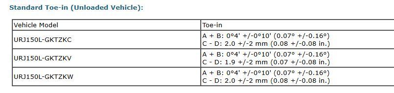

Based on the before numbers, the right side tire wear was caused by excessive toe in. The left side did not show wear due to the negative camber. Also based on the camber and caster angles, the vehicle should have has a right pull.
The after numbers are better but not perfect, IMO. The pull will be gone however but I would like to have to numbers right on spec with the SM. The reason why everything is in "green" is that the SM gives a wide tolerance. I would have adjusted the left camber to .1° and adjust the toe to the spec of .07°.

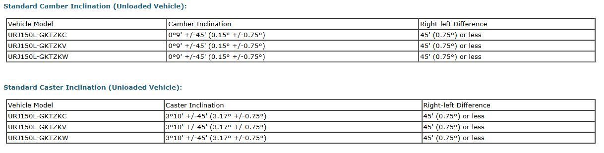

Originally Posted by coolsaber
Anyone know what the ideal angles/ranges are for even wear and straight tracking on the GX?
Here are the specs, below. In order to compensate for road crown, the left side caster angle should be ~0.5° less then the right side caster angle.
