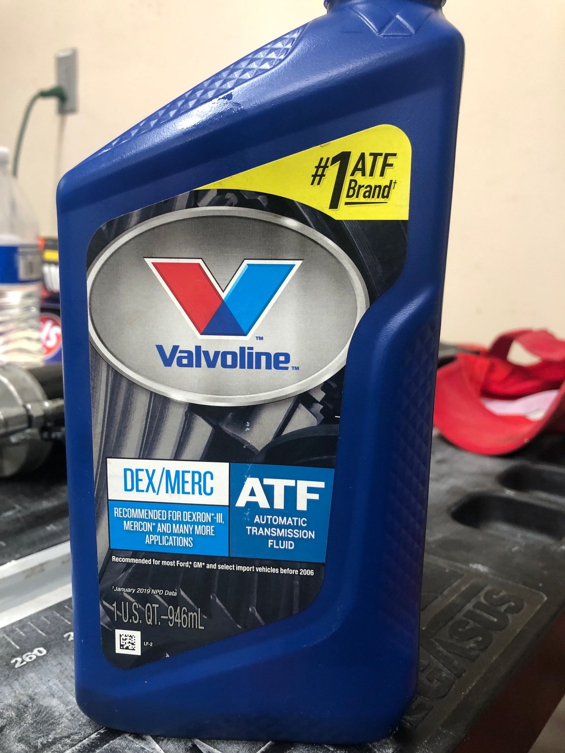

Originally Posted by Therealglove
What fluid should I use ? some people say red line, and some people say ATF
This is what I used.  Check owners manual in case it was changed, I’ve got a 2014.
