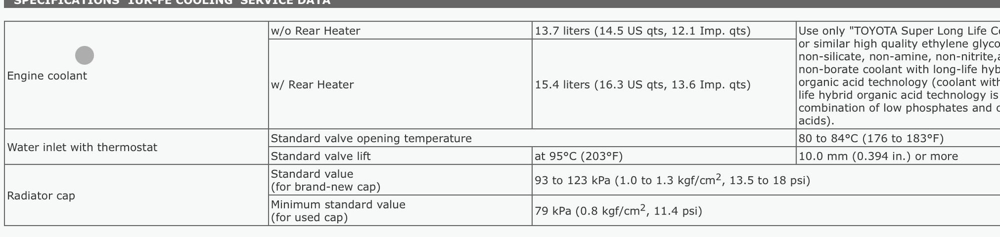

When I replace the radiator I will also drain the block. How much coolant should I expect to need? I've seen a post where someone got just over 9 quarts out is that typical?
Total capacity is 16.3 qts if you drain radiator and block. Probably a conservative number as I don't think the rear heater core will drain completely.

If you don’t have 3rd zone HVAC then capacity is shown as 14.5 quarts
