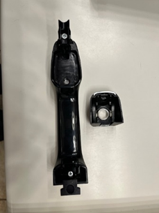

The whole "lock sensor" issue is what has me confused, as the one I purchased came without the sensor. My thinking was that as the current sensor works, all I would need is the handle itself. As I mentioned in my first post, I became concerned that I was about to begin the project without the correct parts, so I began to research this more, leading to my post. Perhaps I overthought it (a rarity for me)...
Attached is a picture of the handle I received from a reputable third-party vendor for the front driver's door. Do you know if this handle simply "goes over" the current sensor and key cylinder? Or do I need to purchase a different handle?

I purchased a driver's front handle from a third-party vendor, so I am confident that I have the correct handle, but the sensor issue has me a bit confused. Does the handle simply "go over" the current sensor and key cylinder? Or do I need to purchase a different handle?

unfortunately that you will need the handle with the build-in sensor to replace the front door handle. Sensor is not a replaceable part, nor it is inside key cylinder if that was what your concern and confusion, The handle that you have bought from third party does not appear that has the sensor. If you look the original handle, the front area where has the line of indent is where the built in sensor located.

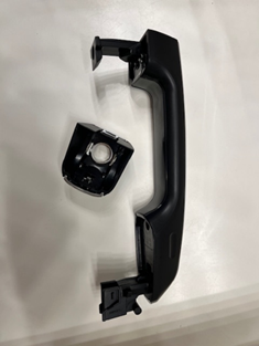

If you need black here are the part numbers.
69210-60150-C0 - Handle, Front Door (Qty: 2)
69250-60030-C0 - Handle Cover, Front Door RH
69217-60150-C0 - Handle Cover, Front Door LH
69211-60090-C0 - Handle, Rear Door (Qty: 2)
69250-60010-C0 - Handle Cover, Rear Door (Qty: 2)
Paint code: 202

Sure thing. I replaced mine last year. These do not have the chrome strip in them FYI and are already painted.
