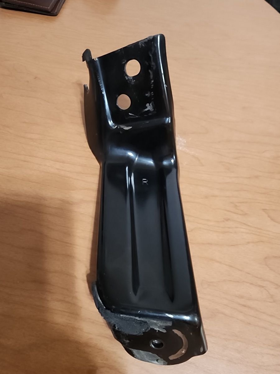

Greetings, long term lurker. 2017 GX. Owner for three years.
I managed to mangle my right front bumper bracket. Reviewed several online schematics, no luck. I am looking for the bracket part number.
Mangled bracket:
Unmangled (or less mangled) bracket (left side)

Unfortunately, I don't believe that bracket is sold separately from the bumper reinforcement assembly.
You may have to look around in the used parts market. Not showing separately on Partsouq either

Thank you Found several assemblies on eBay; 52021-60221. will consider visiting some local salvage yards.

Is it possible to straighten the mangled bracket?

I was able to straighten most of the deformation, The metal area around a mounting bolt sheared off, will weld/braze a washer in place and grind off the excess.
