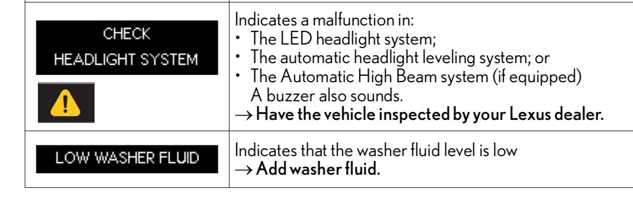

P.S. on occasion when the dome light randomly comes on while I’m driving the “bulb out” warning light pops on for a second or two then disappears.

Not aware of a “bulb out” warning message. Where is that being displayed?
Only lighting based warning messages I see in the owner’s manual

This is the light that pops up briefly

This warning light says it is for the headlights but can illuminate for other unknown reasons. Unfortunately… this doesn’t sound like it is going to be an easy one to troubleshoot. I would try to pull codes with TS or OBD Link/Fusion and it might require a multimeter to start isolating the issue.
