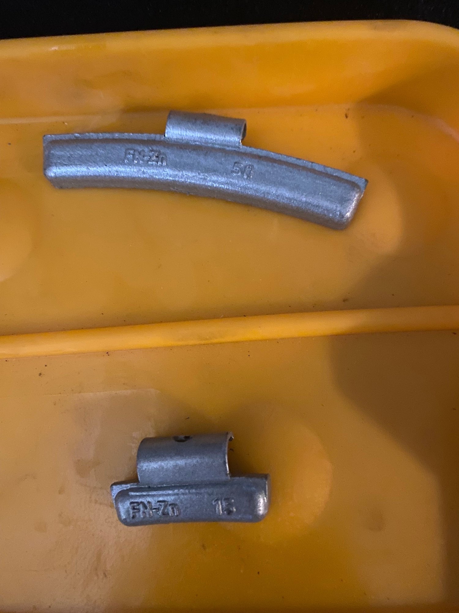

There should be a strip near the spokes side, and another strip near the inner of the rim. Should not be in between or more than one strip plus one odd weight somewhere else.
Here is a 50g and 15g weight, the 50g is equal to about 1.75 oz
What I meant is probably look for less than 2 oz on each side of each rim, less than 4 oz total. If it need so much weight they can clock the tire different and use less weight, installer have to be patient and/or customer has to complain first.
Also the GX wheels most likely need a special cone or in combination plate that holds the lugnut holes to get best results, you should ask them what they use.
If someone used pound-on weights on my aluminum wheels, I would pound on them. Only on Steelies are these acceptable.

I am only showing the difference in size.
Although these are not steelie weights, it's a specific shape to clip on OEM aluminum rim. Those were from 1st gen GX so that was old school tech. You can do clip and stick on for the spoke side.
