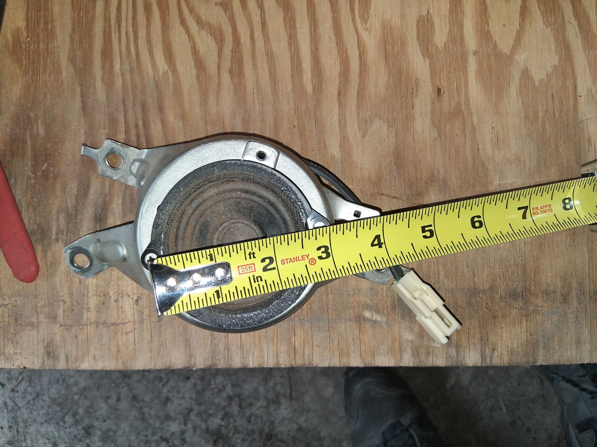

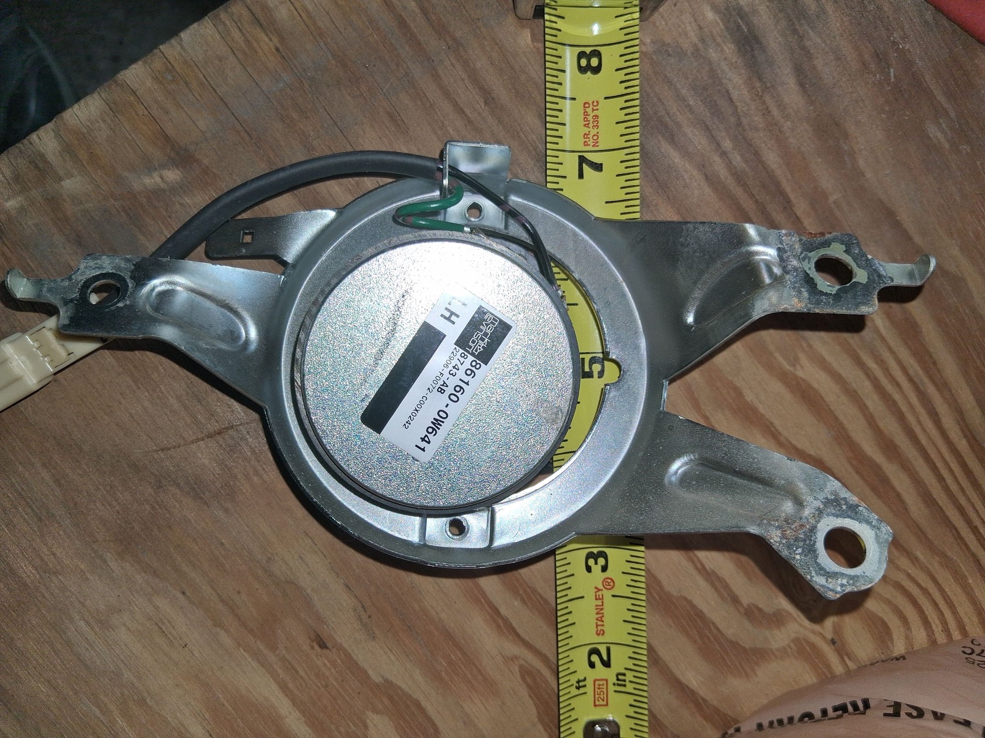

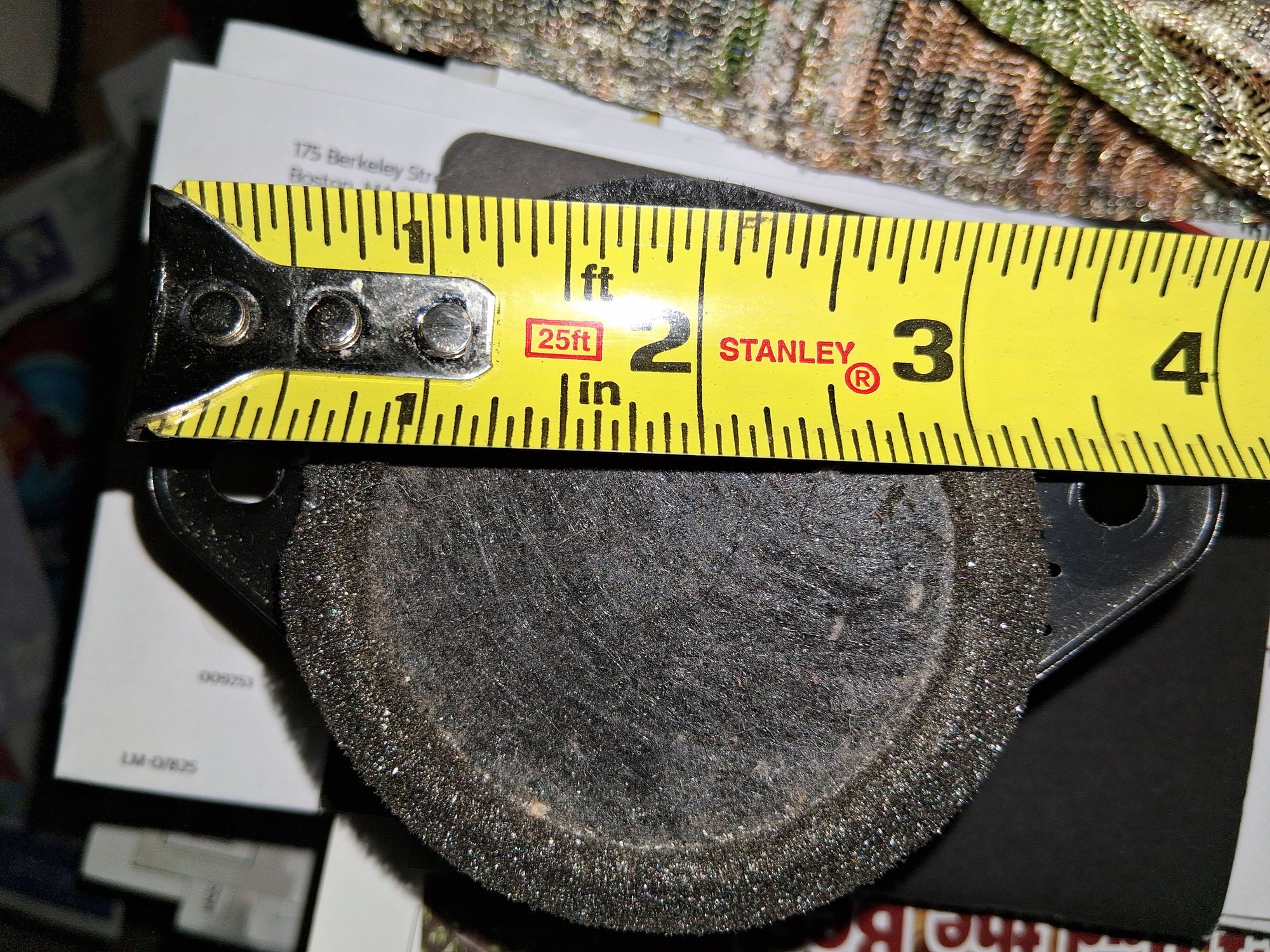

In one of the many threads I read, there were questions about the sizes of the cargo door speakers and the front dash speaker. As I can't seem to find those threads now, I'm going to throw these pics here in case they can help anyone who needs sizes.
Cargo Door speaker::
Front Dash Speaker:

For the grill speaker, I used an adapter that I found on Amazon:
Speaker Spacer Ring Midrange Speaker Spacer Adapter for Toyota Waterproof Speaker Subwoofer Mounting Spacer Bracket Ring Black 2 Pcs Speaker Spacer Ring Midrange Speaker Spacer Adapter for Toyota Waterproof Speaker Subwoofer Mounting Spacer Bracket Ring Black 2 Pcs
By removing the inner rings and elongating the screw holes, it worked well to attach a 2.5 inch 8 ohm speaker, reusing the factory harness from the original speaker assembly. The perspective on the picture above makes the adapter look smaller, but it is the same size and bolts right in.
