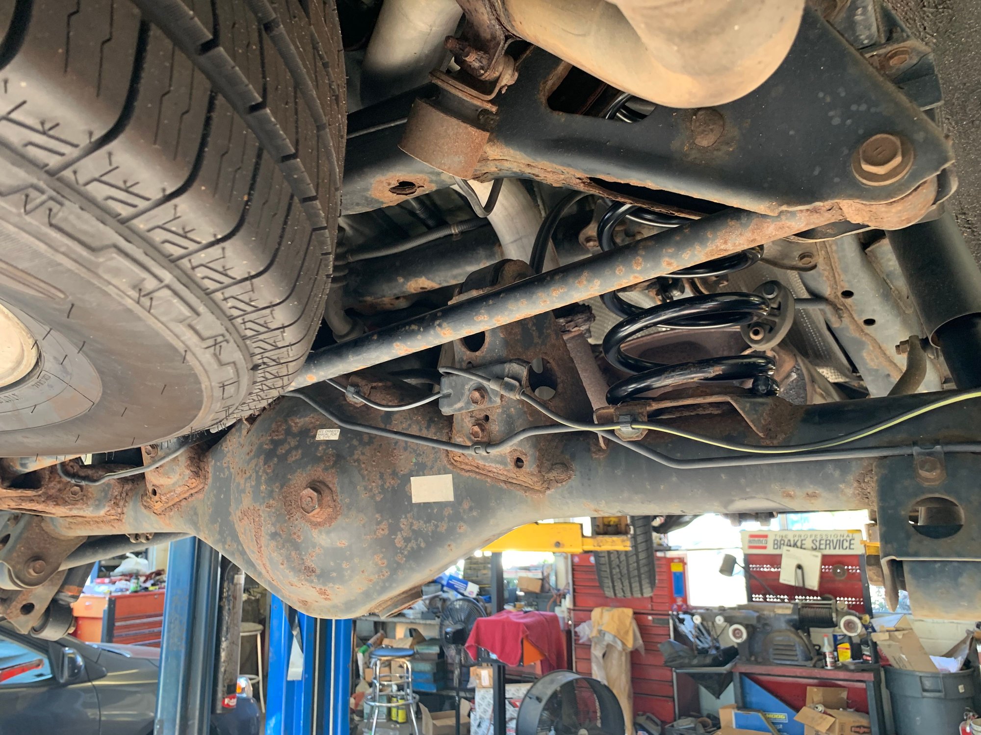

I have read a ton of threads on the conversion from air to coil.seems like there are bunch of different paths people have taken with mixed success. I tried maintaining my air bag system and it continued to ride poorly so I went with the Strutmasters coil conversion on my 2008 GX. It seems to lift the truck a bit and and the ride was improved a lot over how poorly it was handling prior to the conversion. I have notice more recently that running over small bumps it does not handle them as well as the air ride once did. My question is are there other adjustments or replacements I need to make to the sway bars or the lateral torsion bar in the rear to achieve a smoother ride? Both the sway bar links and lateral bar look pretty crusty / rusted. Wondering if the bushings are worn out. I had read that I should consider putting the truck onto a lift and getting it to neutral and loosening the sway bars and lateral torsion bar,
This gives you a look at the ride height
Rusted torsion bar
then retightening while neutral. Any suggestions appreciated Hoping someone has done this with the Strutmasters kit and knows what I am referencing.

You want to tighten the control arms and lateral rod bolts while the vehicle is on the ground, so the rubber in the bushings is at it's normal state. If you do it while it's on the lift (2-post style) then when you lower it there is going to be a twist applied to the rubber all the time, and that will wear it out prematurely.
I still have the air springs, so I don't have an opinion on the Strutmaster conversion. But you can certainly check the condition of the bushings yourself with a strong flashlight.
It looks like your shocks are dry, so they're not leaking. But they still might be worn out - if you bounce your weight on each corner, how many rebounds before it comes to a stop?
So far as the rust - that mostly looks like surface rust. It can be cleaned off with a steel brush, then use a rust converter like Corroseal on it. Protect afterwards with an underbody coating. Someone from a northern state will have a good recommendation.

Thanks Chip. I think the struts should be good. The pics were actually taken during the conversion so you may see that one side still has an air bag and another has the spring. Both struts were replaced. Does the ride height look higher in the first pic? If so I read that I would want to get Dobinson sway bar links and extent them 1/2 the amount that the truck is higher than stock. So in other words if it is lifted 2” above stock to extend the sway bar links 1”. I didn’t lift the truck but it does seem to be sitting higher. Not sure what stock height is or how to determine where it is now.

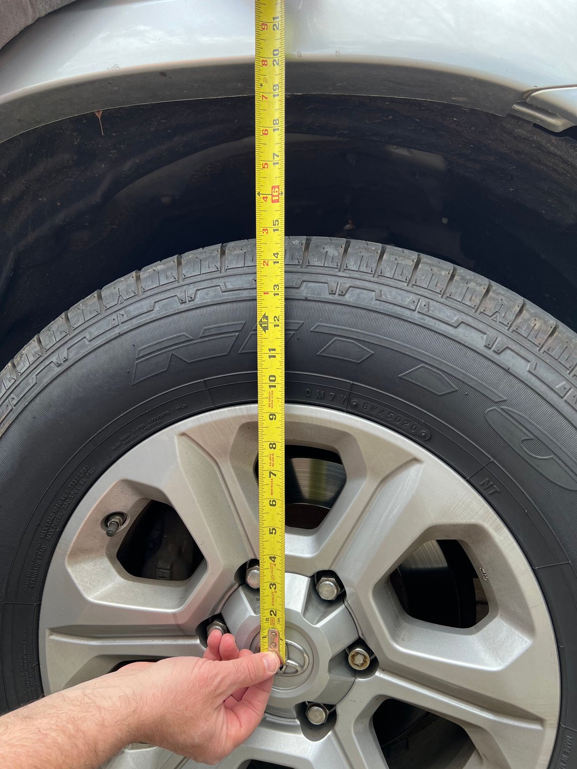

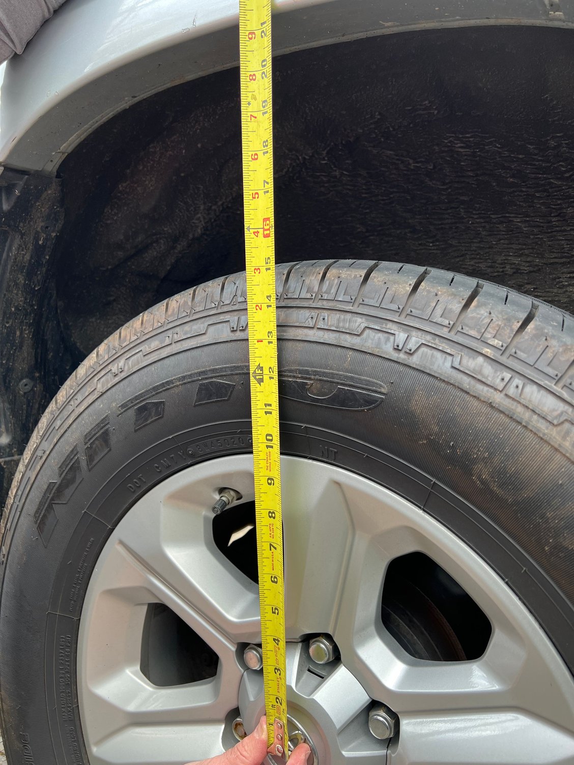

To determine ride height, measure from the center cap of the wheel to the fender lip. This takes tire size & inflation out of the equation.
My front is 19-3/4" and the rear is 21" (stock air springs)

Chip:
I assumed you meant center of the center cap, so here are my Truck’s measurements
Front
Rear

Yes, that's what I meant.
That looks to be within spec.
