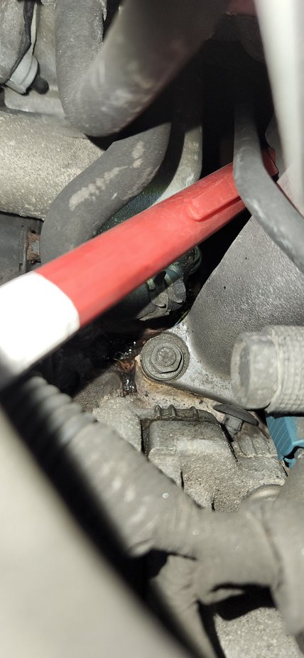

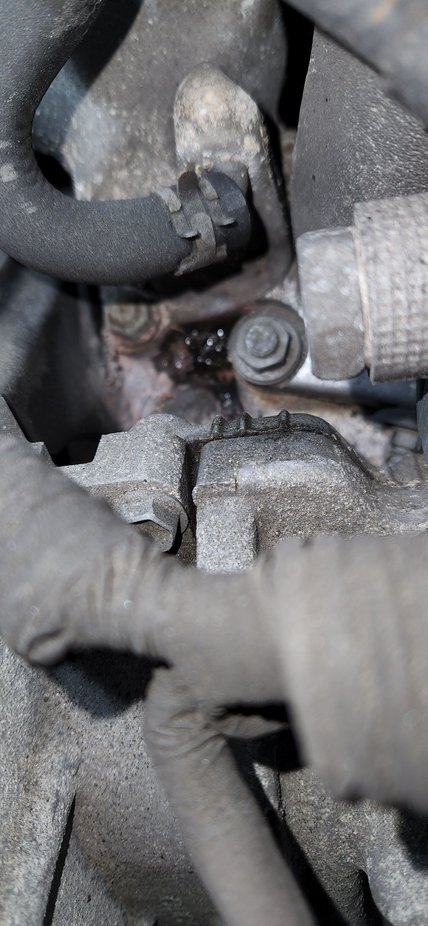

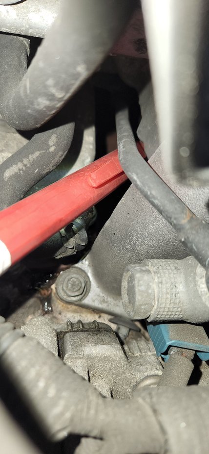

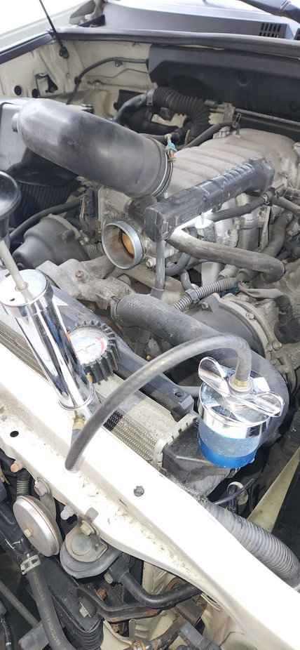

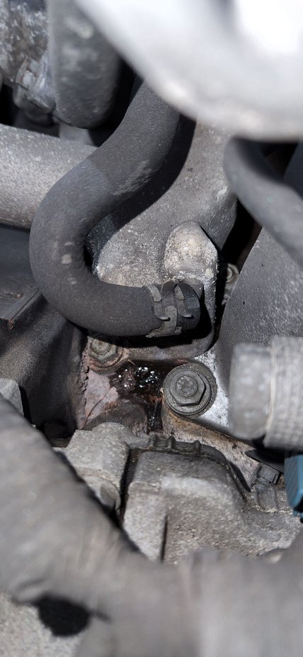

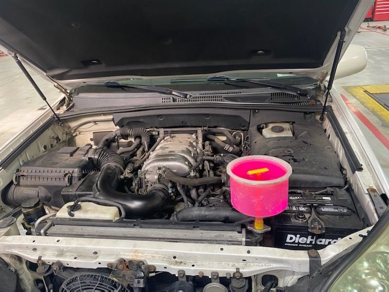

The coolant was going somewhere. It was
driving me crazy but I finally found it. I won't be able to do this. Looks like I would have to remove engine cover and more.
I saw some old threads about a radiator leaking but they couldn't find it. Mines is a 2004 with 153k. Timing belt was done at 126k.

Is that the coolant crossover pipe?
Yeah, bubbles are bad.
Chip H.
The x-over on rear-upper engine is where it starts to leak. On my 06 253kmi I noticed a little pink near the gasket end on the flex x-over tube when I had intake off. Figure I replace that when I do the starter.
The 470 engines are fixable, but for some things are a real pita.
Chip H.
i don't what is call but no bubbles.
sh... is that where the starter is? Like the GS400.
I'll probably take care of that as well.
I'll do some research X-over pipe gasket or O ring.

I believe xover tube is a gasket.

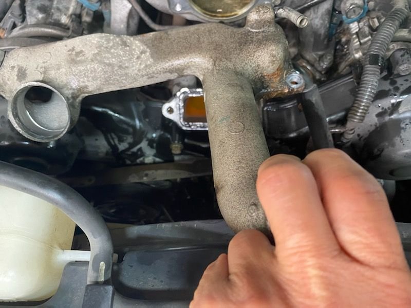

Old Mar 31, 2022 | 03:58 AM
angelslex's Avatar
angelslex
Posts: 1,134
Likes: 16
Did the whole front. Was able to get it out by removing throttle body.
