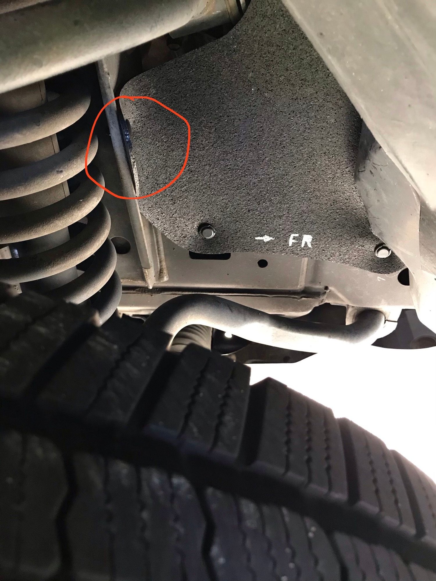

You will be happy with those! I just bought them (from Amazon) and put them on today. They are definitely high quality, and the price can’t be beat since it comes with new clips and the special tool to help remove them. The only thing that did not go smoothly was that there was 1 spot on each side of the rig where the clip wouldn’t fit on my 2004. I tried everything, and it simply wouldn’t go on. You can reuse 2 old clips (1 on each side) or if you lucky like I was, use an extra oem one laying around the toolbox. You also could use a zip you wanted to on that spot.
If i get a chance, I can take a pic of the spot later.

This is the spot where the given clips won’t fit. After reading the reviews, looks like I’m not the only one with the same issue. Nonetheless, I highly recommend them. As you can see, it’s in a spot where you could use a black zip tie if you don’t have any more clips, or can’t reuse an old one.
Don't use that clip there, just a push-in from Autozone or the like.
Did you see post #5, clips like that hold better.

yup that’s what I did. Thankfully I had some extra OEM ones from when I replaced the aprons on my wife’s 08 GX470!
