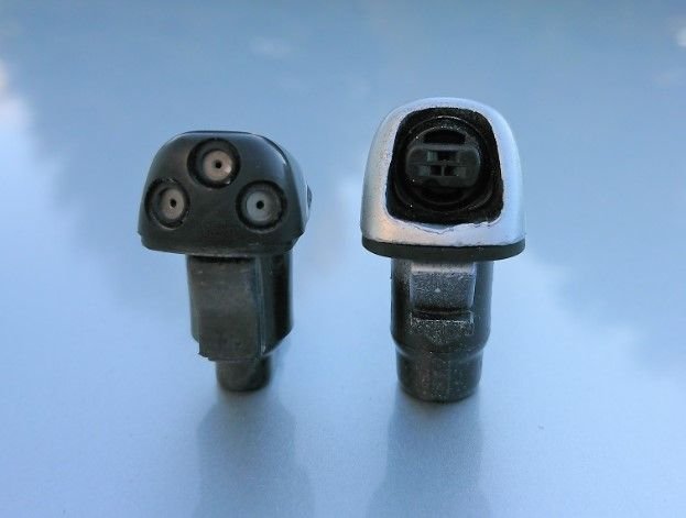

So some time ago a bunch of us Tacoma drivers went scouring the interwebs and junk yards for some better sprayer nozzles. Not a fan of the two jet sprayers. We found the Honda Odyssey part #76810-TK8-A01 and it was a direct swap. Cut to the GX and it's three jet sprayer isn't that great either.
I decided to try another Honda sprayer. This time from a Pilot. Part # 76810-SZA-A01ZA. A bit pricier so I just got the cheap Chinese ones for $10 a pair vs $40 a pair for genuine. They sprayed just as good as the Odyssey sprayers did.
I even painted them to sorta color match. They are also adjustable.
If these ones fail on me I may replace with genuine Honda ones but until then these will do.

Did this mod too, love it. Small things that count. Tacoma ones work as well, PN 85381-04040
