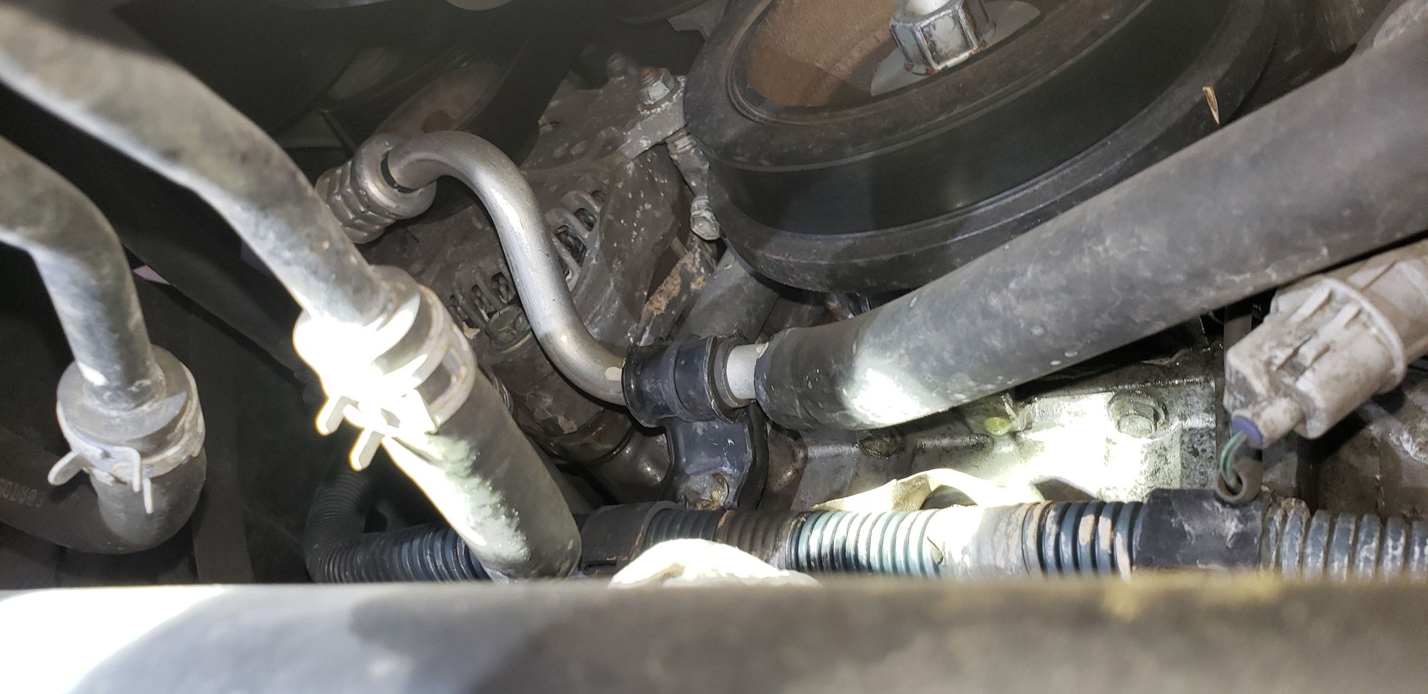

I'm back from vacation to dive back into my coolant leak. I removed the skid plate to see better from the bottom. I took some pictures of where the drip is coming from. I don't see any of the hoses leaking. The water pump feels nice and tight connected to the fan assembly. Pictures to follow.

This shot is from the front directly under the serpentine belt system. When I topped the coolant off it leaked from the lowest pulley joint. The pulley directly under the water pump. In the last picture, the light is shining on the area of the drip. Bottom right area of the picture with nut.

It looks to start coming from behind this one bolt on black plate. Then it drips down off the cross brace in the next picture.
After the engine is cranked the leaks look to be more active under the fire wall area. It looks as though it is leaking from multiple spots? Very scary.
