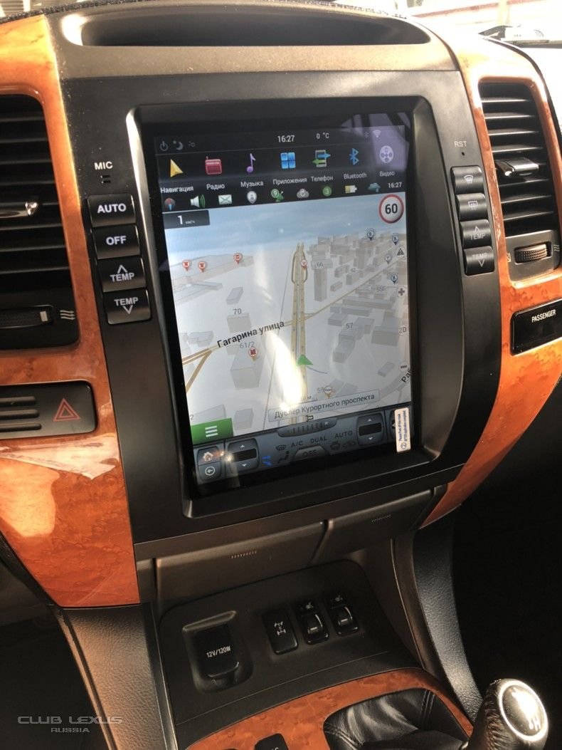

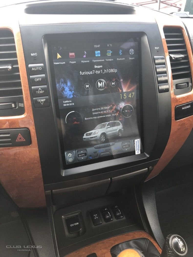

Old Jan 10, 2019 | 02:43 AM
mapdv's Avatar
mapdv
Joined: Dec 2018
Posts: 31
From: SPB
Originally Posted by chiph9
If you want to replace the entire touch-screen unit, some people have been able to use Chinese Android-tablet-based units. Do a search.
Example,
