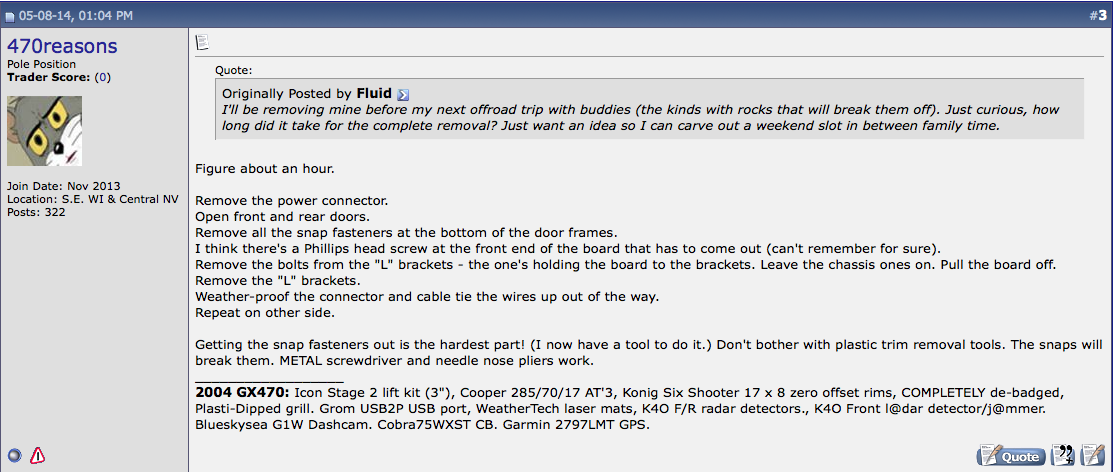

Just finished removing mine; total time was < 2 hrs (not including some pre-reading on this site).
1. (Last night) The first side was slightly more than an hour since I wasted time trying to figure out where the clips were ... I spend quite a bit of time looking UNDER the running boards below the truck ... DOH!
2. (This morning) The second side took < 40min beginning to end.
Acknowledgement to the following guys for pre-reading info: Man777 (clips), RCsGX (diagram), & 470reasons (steps he took - I forgot to read this again before doing it otherwise would have known where clips are located!!).
Attached is some info as referenced above, so you don't have to search for it again.
