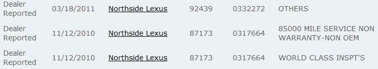

You can check your service history here: https://secure.drivers.lexus.com/lex...-lexus/home.do
My GX was a 1 owner before me and the lady religiously serviced it at our local Lexus dealer. I have all the records from day 1. Since owning it I've taken it to Toyota twice for an oil change and when I was in a pinch I took it to Valvoline for an oil change. Toyota reported on my records but Valvoline did not.
Interesting..... Service work done on our Lexus at our local Toyota dealer (lots of it) has NEVER been reported on the Lexus database.
That's weird. I didn't even tell Toyota to update it, they just did but for some reason their dealer name doesn't show up but Lexus's dealer name does?
Maybe ask your Toyota dealer to update just so it's there for future reference.
