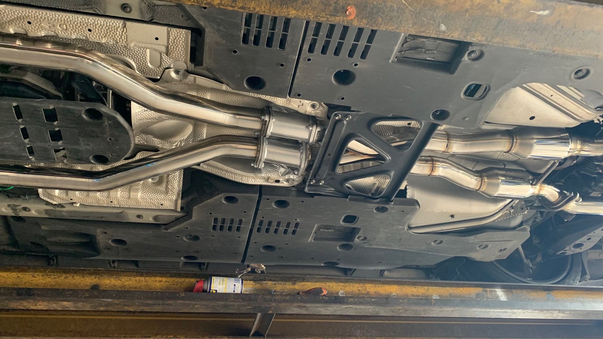

Here's a picture of the stock exhaust:
The Invidia exhaust, when bolted on to the headers, is too short. In other words, the pipe downstream of the headers is unable to reach the mid-pipe (see picture below). What they ended up doing was GENIUS, IMO. They took a piece of pipe with a similar ID as the Invidia pipe, welded flanges on both ends and bolted one end to the mid-pipe and the other end to the pipe that's bolted to the headers. Therefore, eliminating the gap. In the picture below, the left side has the extension bolted on whereas the gap is visible on the right side pipe.

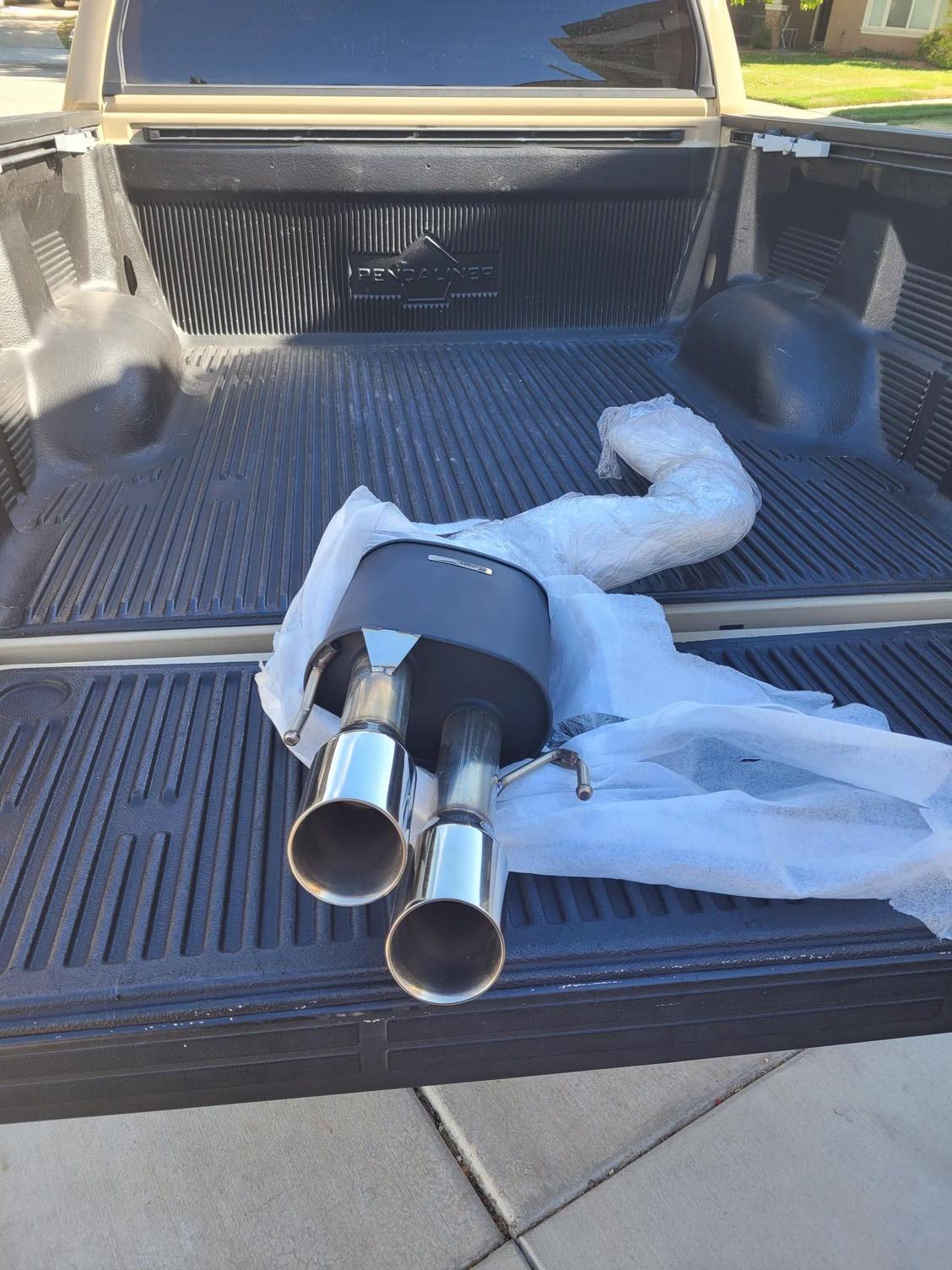

I went the same route with the invidia.. $150 to install here in MN. Looks and sounds great. Lots of compliments.
