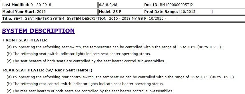

The heat range on the GSF seats (and most Lexus seats) are small. IMO, they aren't the greatest. But if you have a laser thermometer, press it against the seat and take multiple reading on the seat back and cushion, then average them out. The elements themselves can get up to 106-110, so with the cushion, I'd say about 90 or so.

That's good to know but the primary criterion to me is whether or not it warms up my behind and back comfortably enough when the weather is cold. It does not.
It's a subjective opinion but having had multiple cars w/ seat heaters, Lexus included, my butt tells me the GSF seat heaters barely gets warm and does not accomplish the mission its required to do
