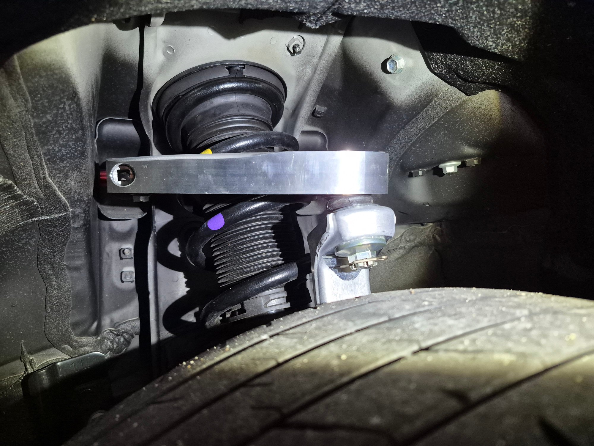

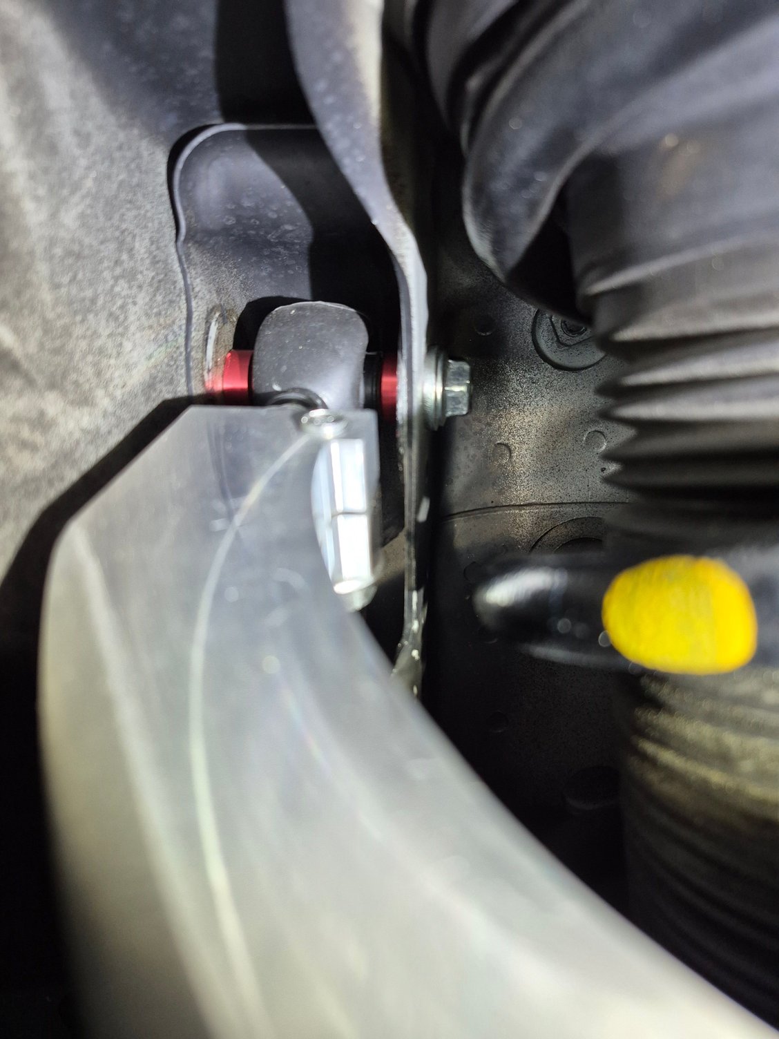

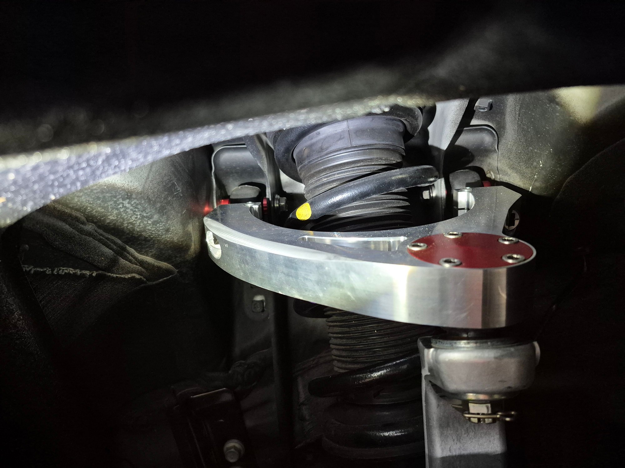

Update - I took the plunge and bought RR Racing R2 UCA for RCF/GSF. Have them installed and quite happy with them. I haven't noticed any change to NVH (yet at least) and have driven on a mix of smooth, bumpy, and broken pavement. I did add some heim joint boots to protect the spherical surfaces from debris, muck, and water.
