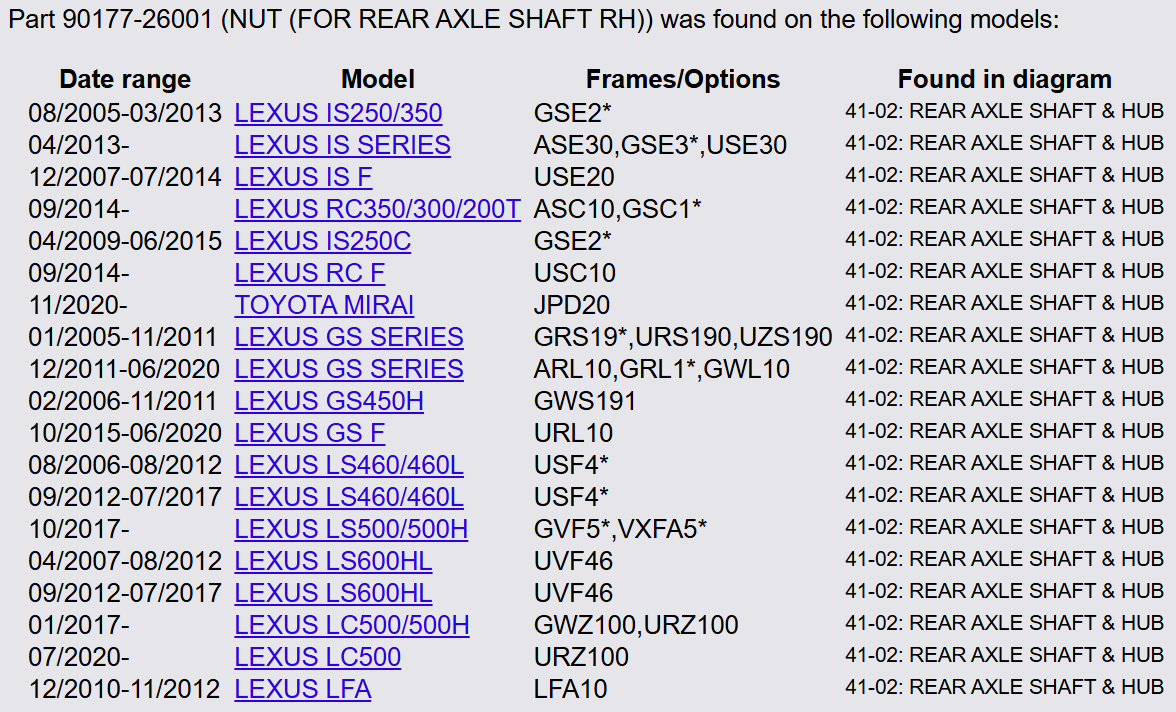

90177-26001 Nut, Lock. This is a very common part, but it is not common for it to become loose. Torque is 290 Nm/214 ft-lb. These nuts are also staked at the factory to prevent them from coming loose.
