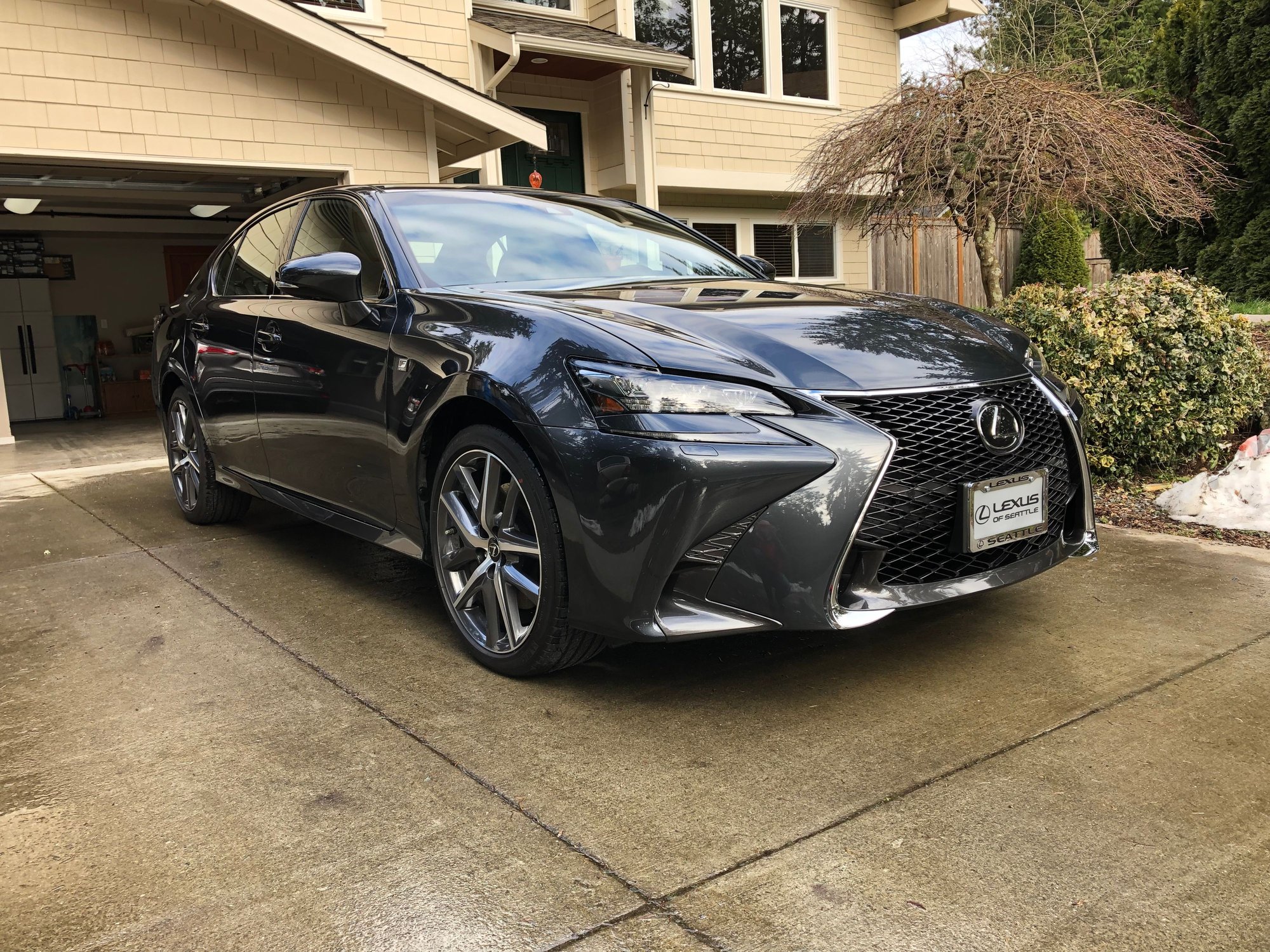

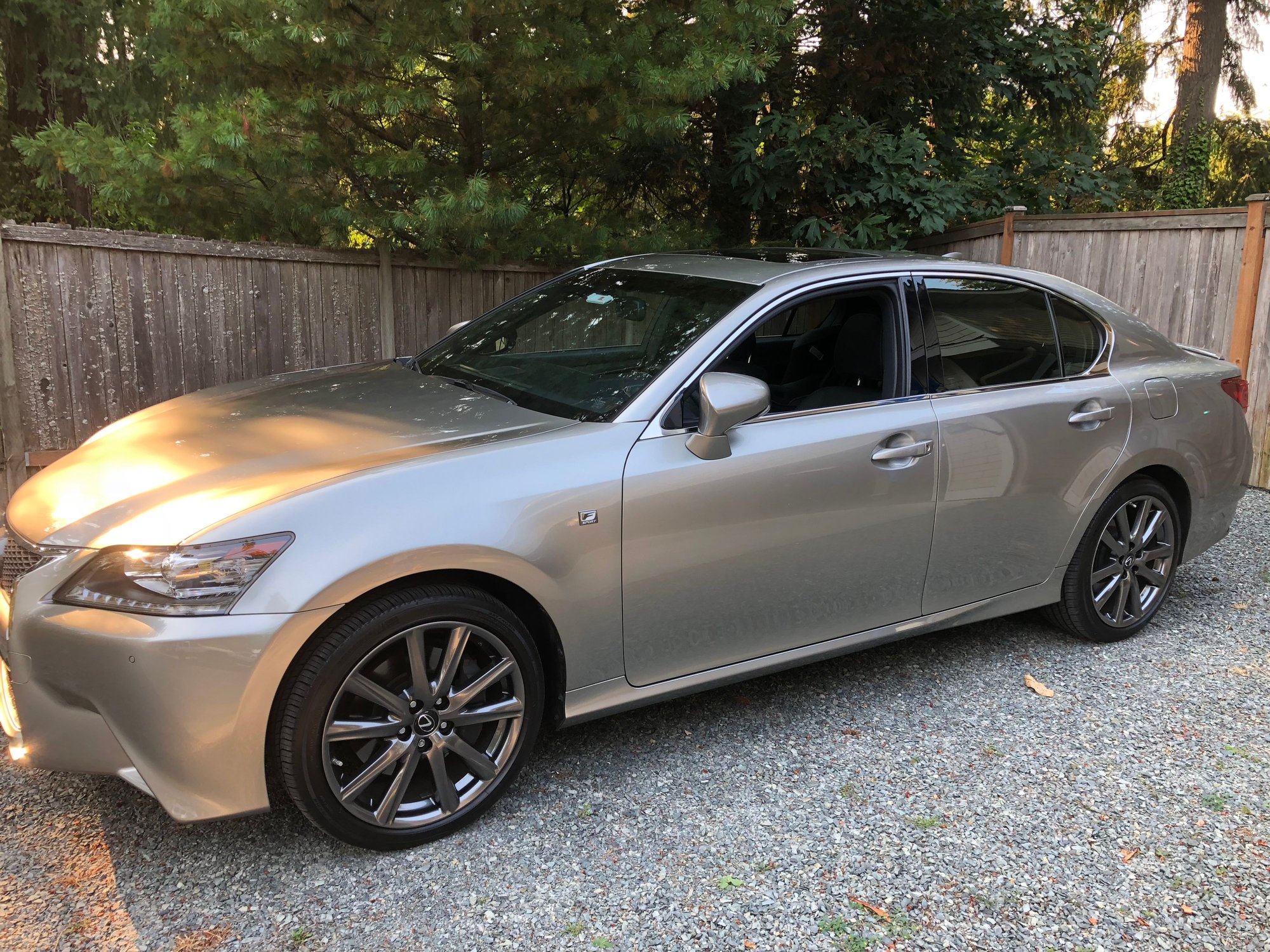

I’ve had both a pre-refresh (2015) GS and two post refresh GSs (19 and 20).
There is no such thing as a wrong choice here. GS FTW!

I’ve had a 15, a 19, and a 20. All were great for different reasons, but I prefer the post-refresh models.
