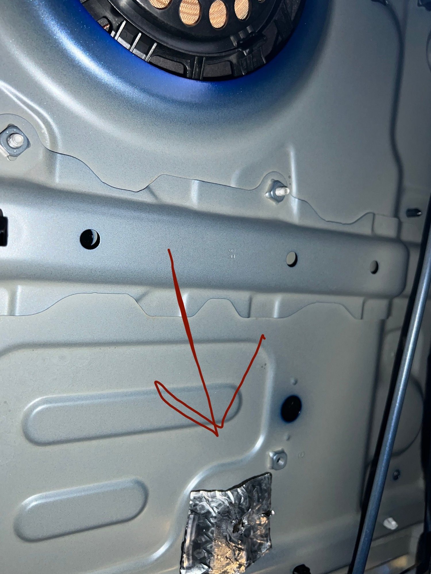

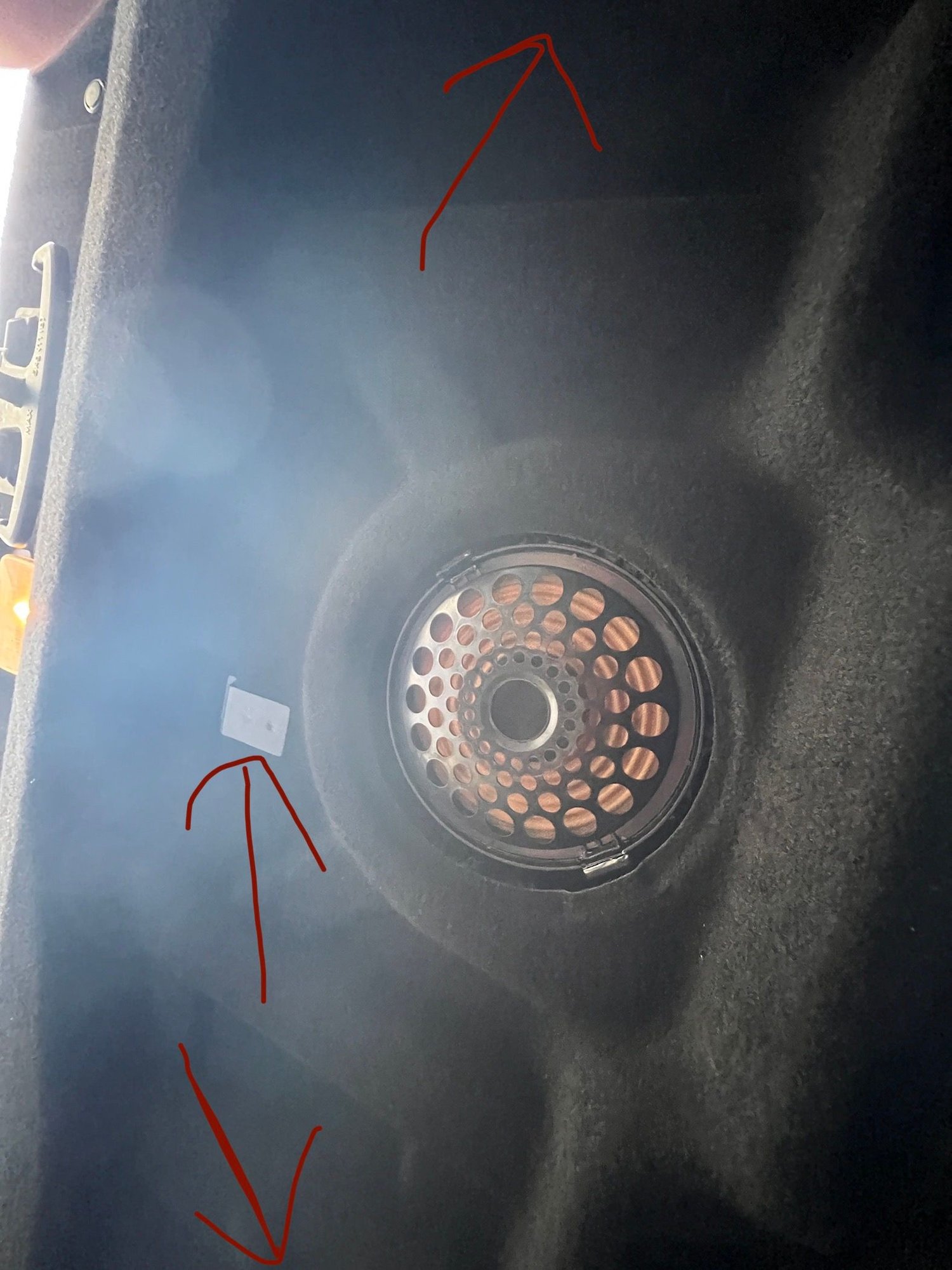

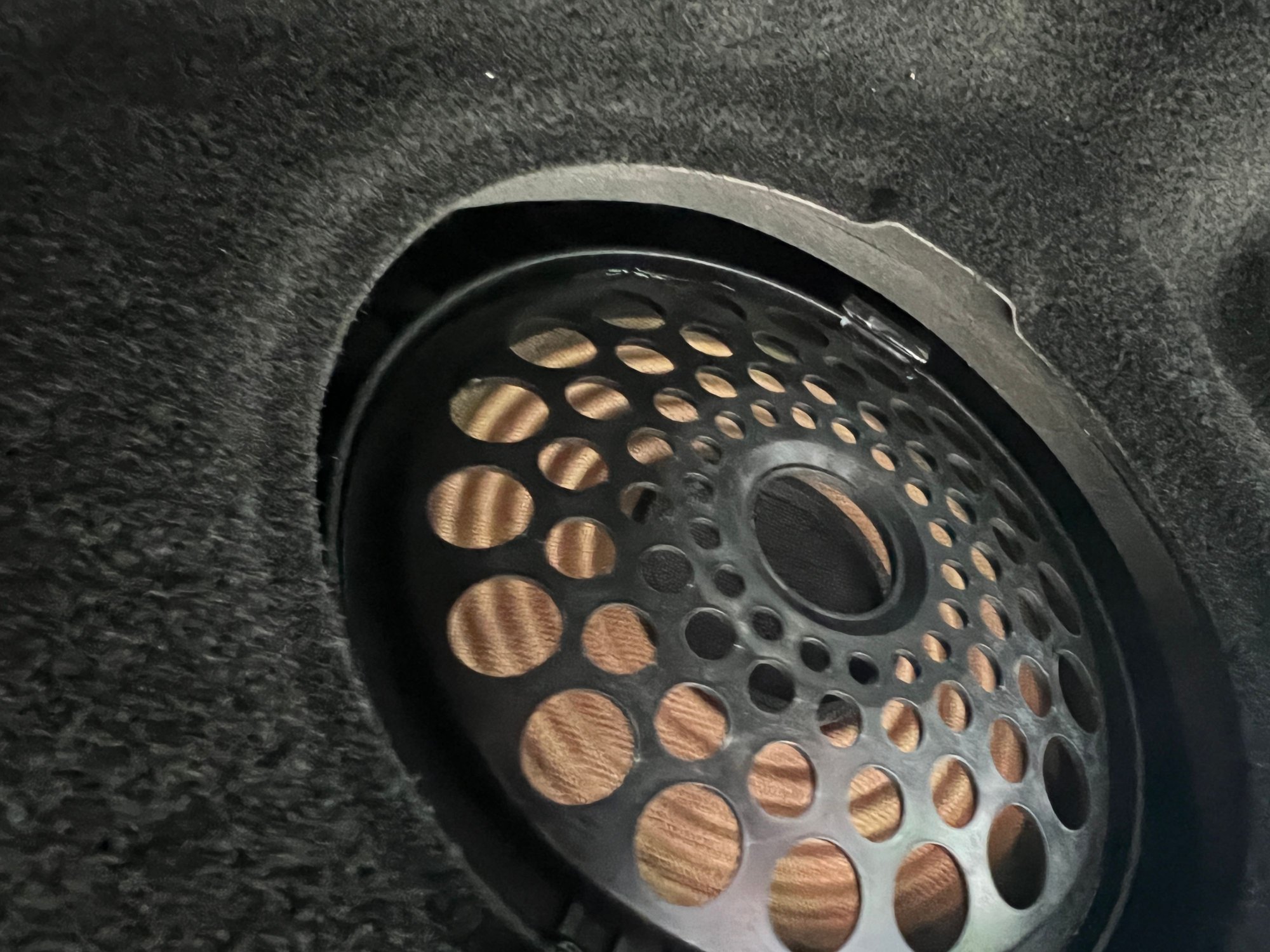

Maybe these pics are more clear?
I tried it, and honestly didn't noticed too huge a difference. Then again maybe it's my music? Lots of bass-heavy stuff (Lately a lot of Deichkind).
I'll seal around the sub another day though, maybe that'll help a bit.

What I made there were patches over the holes. It's 3-4mm thick bubble wrap with a layer of Nashua rubber all weather tape.
