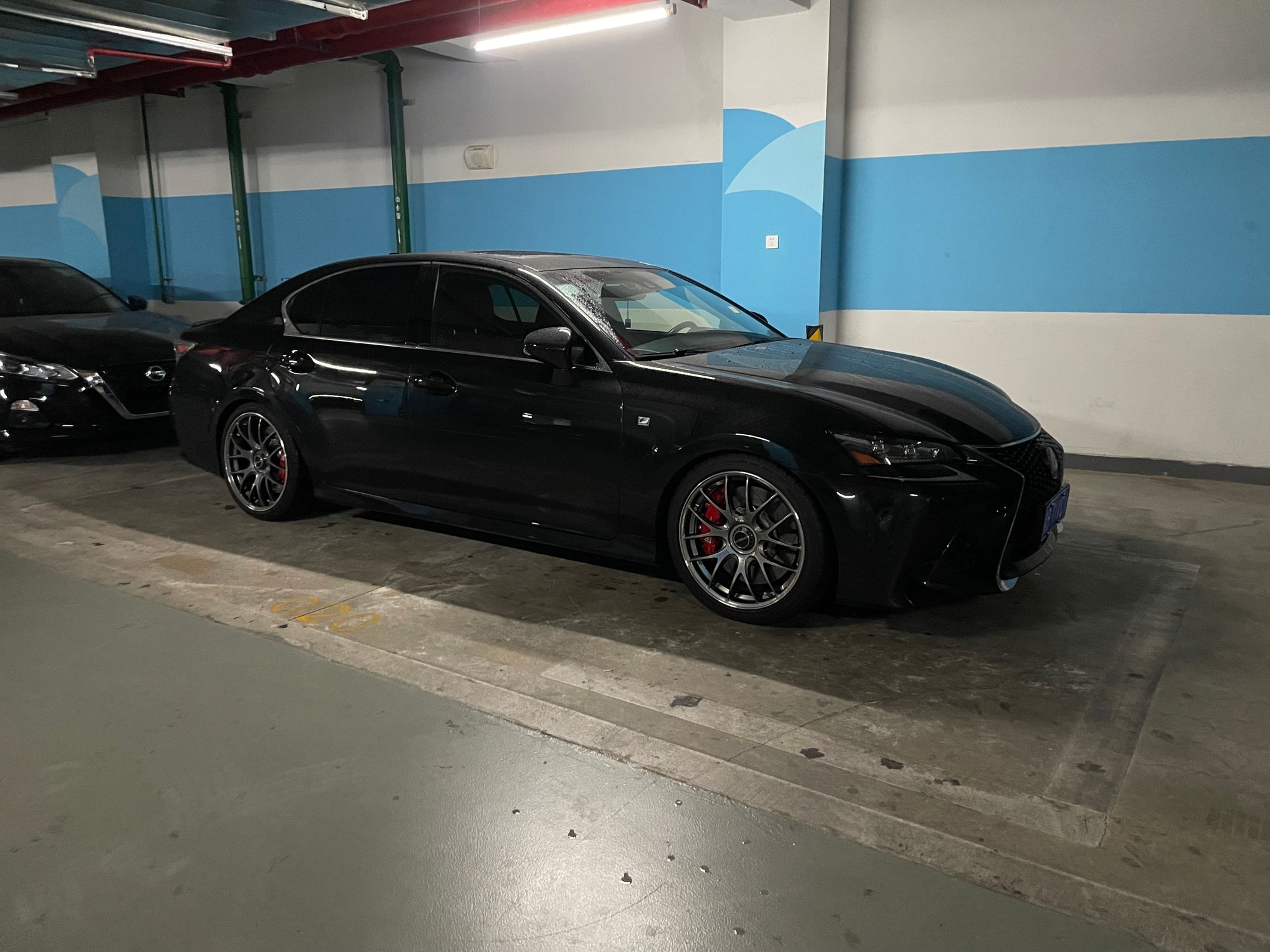

Below is a picture of my car now.

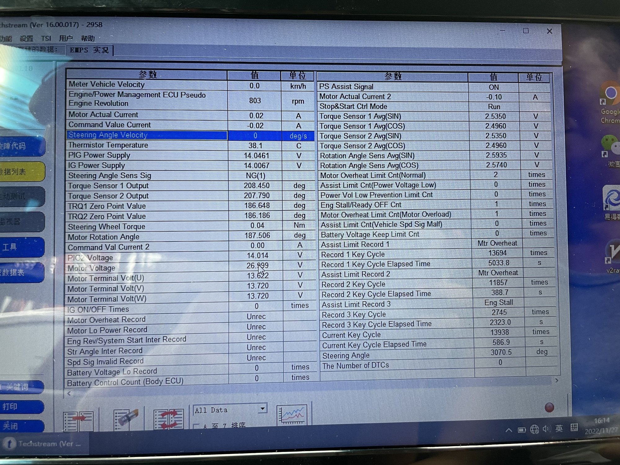

Thank you for your help, I have done the steering angle zero and headlight level correction as you said. The picture is the data obtained after I learned the steering angle, can you understand it? I can't quite read it, and I don't know if this is correct.
