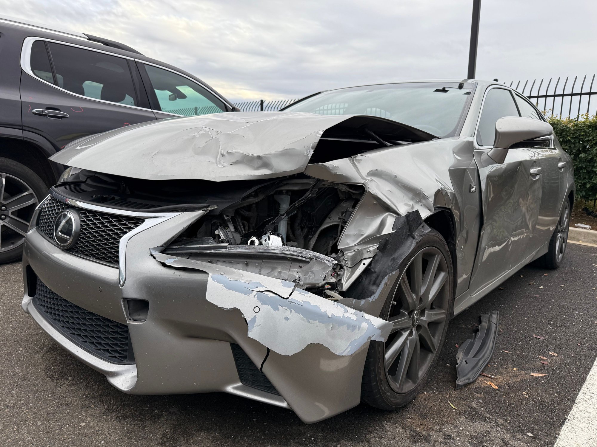

This really sounds like what I’m hearing. I was hoping to crawl under there this weekend but a deer had different plans for my car. Guess my problem is fixed!
