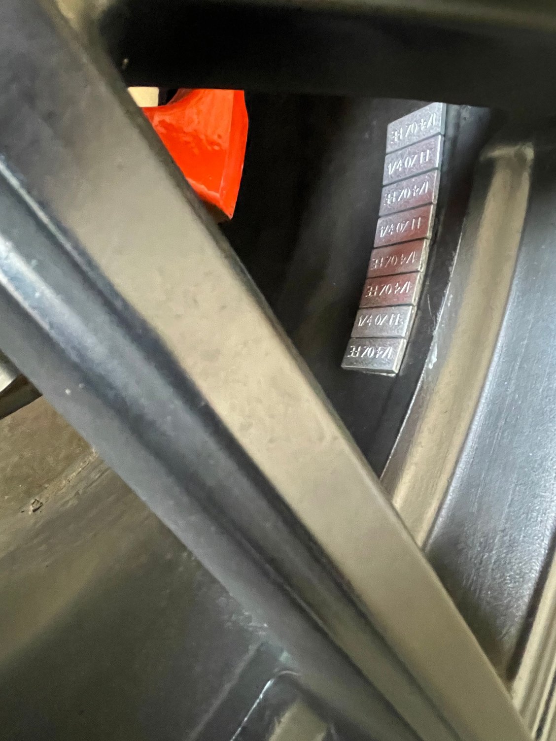

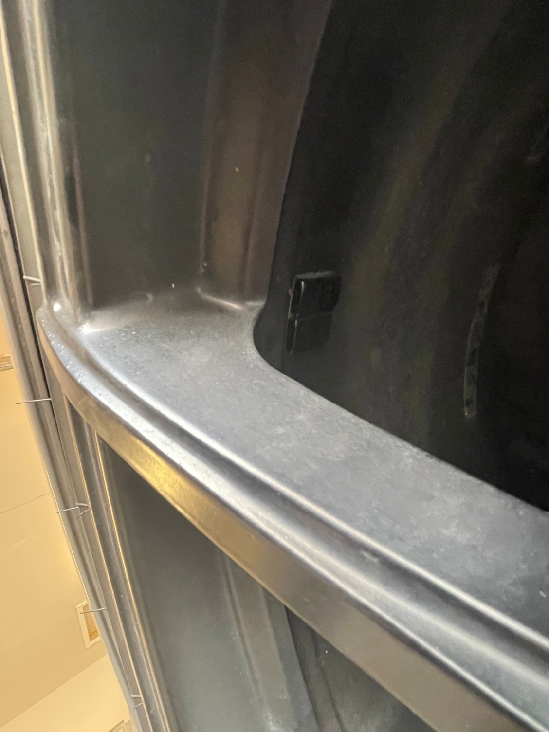

This rear one just has these two small weights
The other has all these. Is that too much? Like maybe it was bent and we’re trying to balance at all costs? Lol

I don't think that's too much. I've seen that many on my old Camry's aftermarket wheels before. Depending on the build quality of the wheels I guess. If u've got weights all around the wheel then u got a problem.

Yeah that's too much, that rim is messed up. I'm sure numbers were all over the place trying to balance that rim. You'd have to bring it to a professional shop to fix these wheels, but it will probably happen again after hitting some potholes. Back to stock.
