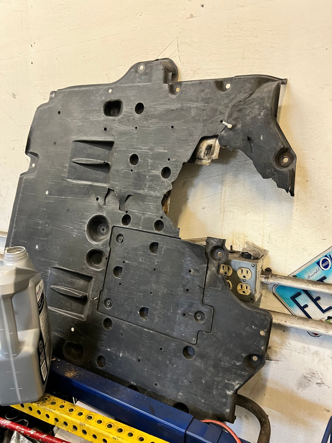

what year is your car? My 2016 has also been rattling but I’m not sure if it’s center console or something under the car. I ran over a car battery last year and it broke the shield. Then I tried to remove the shield and it still makes the rattling sound. After that I had it lifted and tried to remove two other plastic pieces but still no solution. I noticed it makes the sound more when I turn right and accelerate. Before it seemed to only rattle in the morning but now it’s all the time. Adding photos and videos for reference.
