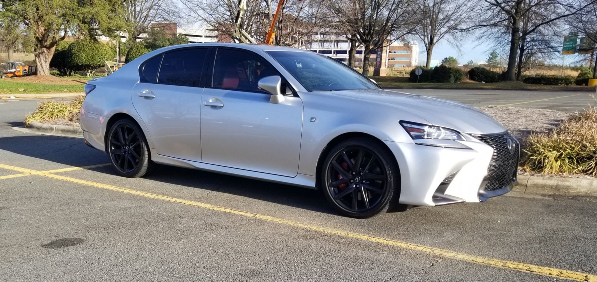

Sanded and prepped
2 layers of primer
2 layers of black gloss
3 layers of clear coat and awaiting for a few hours before install

This was my weekend project. It was dark when I got done and I will post another pic on Christmas Eve after I wash my car

Going for the Black Line look? Rims look like they came out pretty good, nice gloss. There's another member who did them all silver.. that's the color I want to try.

Did you spray them in the garage with the vehicles? How was the overspray?

Nice work, hopefully that lasts long term. I would highly recommend spraymax 2k clear coat:
Amazon Amazon
It's a two component clear coat, that sprays very smooth and much harder/durable/glossier than regular clear coat. I used it when I painted my calipers a couple years ago, still looks fantastic.

You need to take the wheels off and cover the entire car in plastic(buy from home depot). When you spay it goes into the air and it will land on the car even if your spaying on the other side of the garage.

I sprayed then in my backyard actually. Then put them in to dry

I sprayed in the backyard far away from my car
Im gonna look into this in the future. With that 2k, I have to get a breathing filtered face mask
