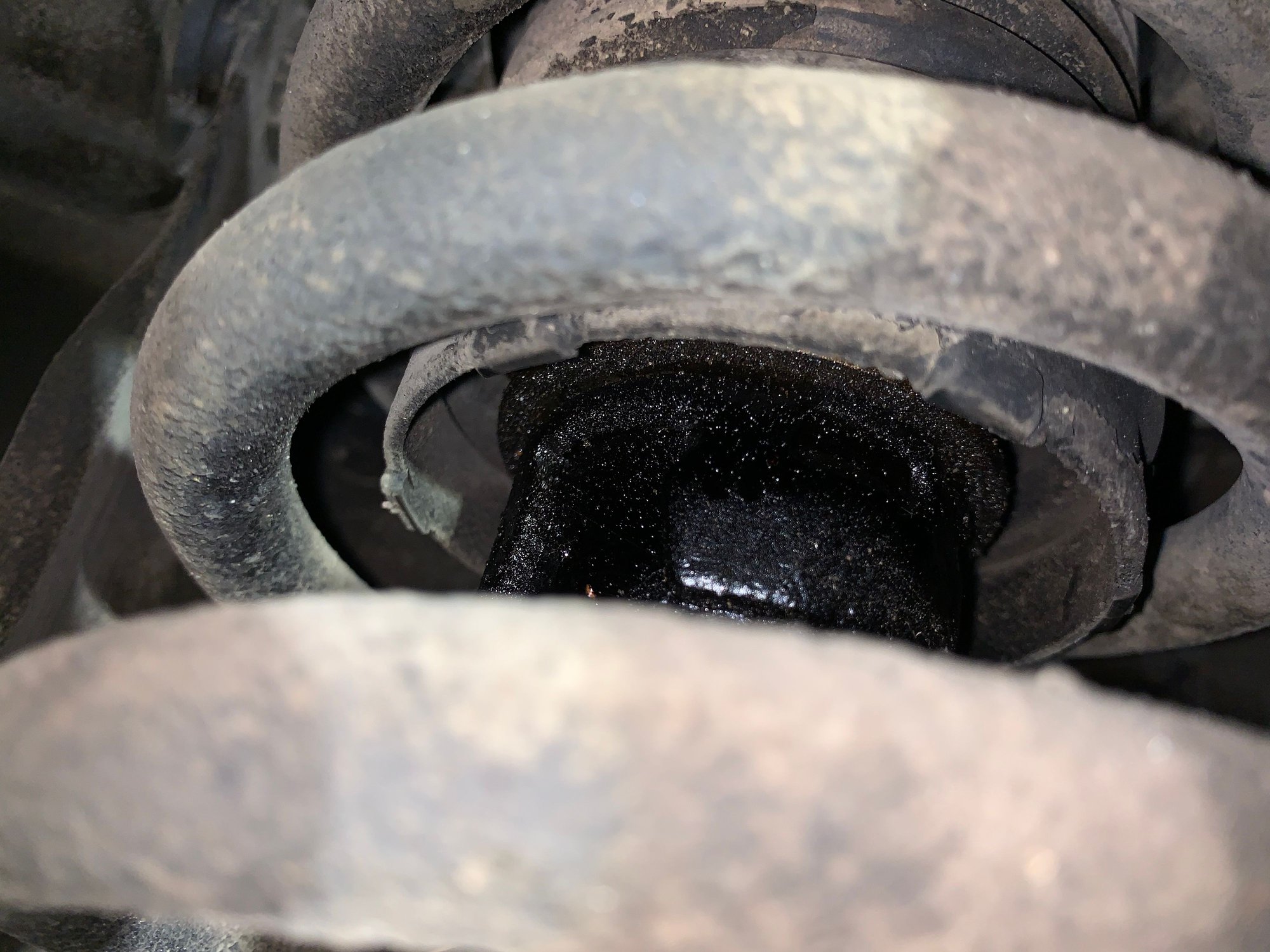

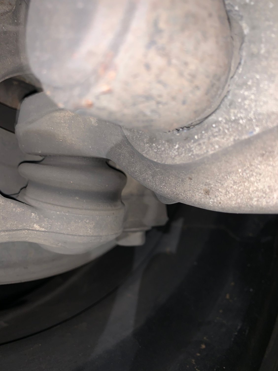

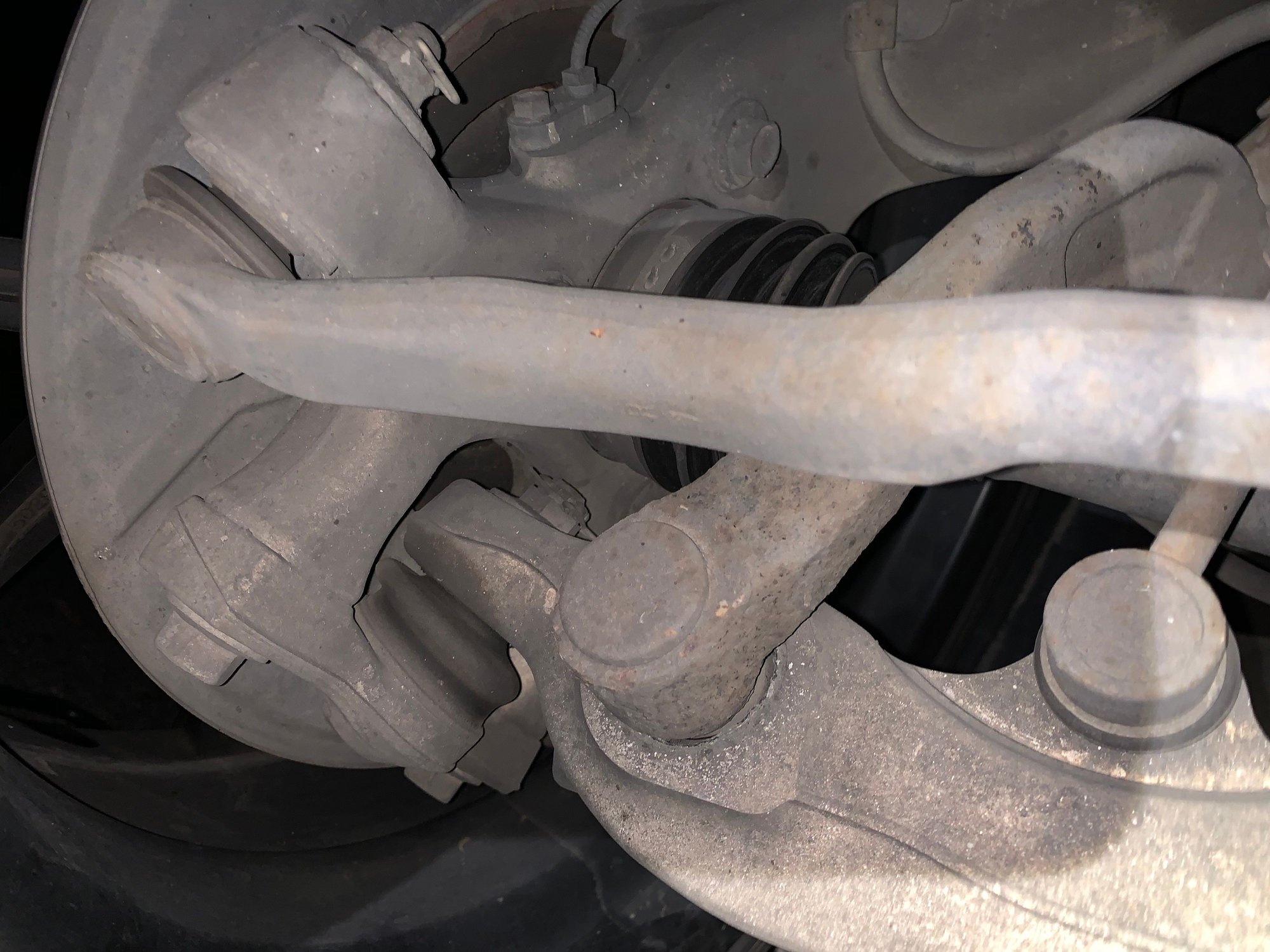

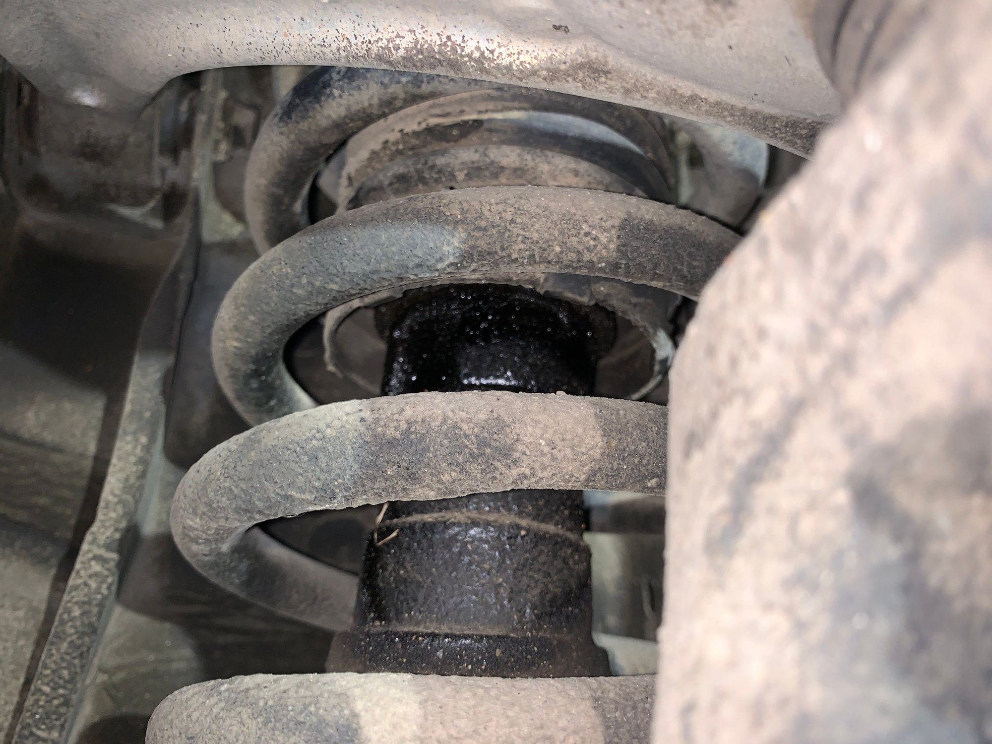

Attached photos are
some part I don’t know the name of but the rubber part is cracking, typical on left and ride side of car
two photos of lower ball joint, upper ball joint was in same condition, both sides of car looked the same
Two photos of leaking strut

Your struts are leaking pretty bad and the rubber on that bushing is completely shot. I'd say both need to be replaced. Did you or a previous owner run larger rims or aftermarket suspension or hit a lot of potholes, any combination of that could have led to the problem.

I have 19s on it that came when I purchased the car. I guess I’ll will change out both parts. 82k on the car. The left strut is barely leaking compared to the photographed strut and the photographed one doesn’t make any noise...
