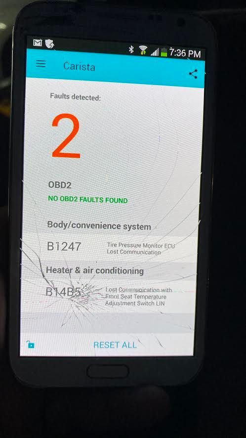

Hey, guys, I had fuse tap on my gs350 for my fog lamps which I no longer use soI removed it yesterday it was on the passenger side fuse box it was a tap on the ignition fuse so when the car is on the lights will be on. So i removed it cause I no longer used it anymore so I remove the fuse tap and put back an original 10 fuse back. after starting my car I see the tire pressure light is blinking which was weird so I try to reprogram it with the carista app but i found 2 errors below:
This morning driving to work I realized my driver side is blowing air and the passenger side ac is blowing cold ac and my heated and cool seat is turning on no power at all
what can this be I reset the car by disconnecting the battery same thing?
can it also be that I did not but back a powerful fuse I'm not sure?

Check all your fuses, driver and passenger side, sounds like you blew one out. Did you disconnect the battery when you did all this? Otherwise hopefully do didn't fry your AC amplifier or some other ecu.

Hey yeah, i was able to figure it out I blew one of the fuses on the passenger side. No, i did not disconnect the battery everything is working perfect now great.
