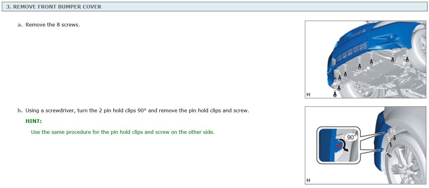

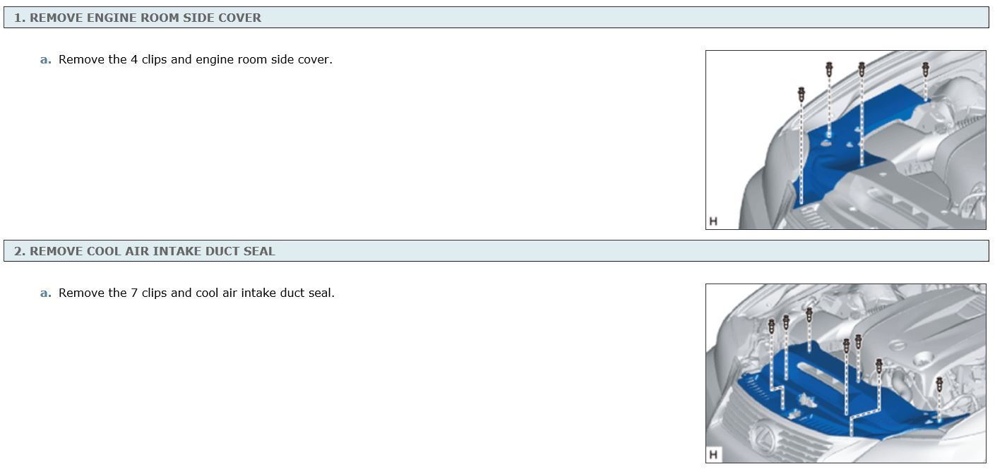

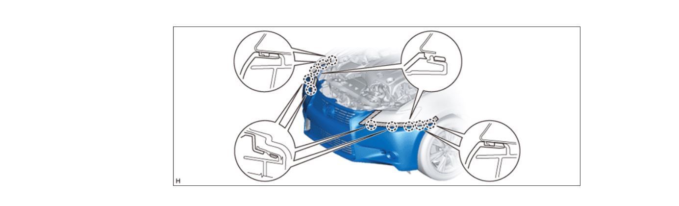

Removing the front bumper is easy, its a fair amount of bolts but not hard to do. You probably don't need instructions but I'll give them to you anyways so that you know what to look for.
