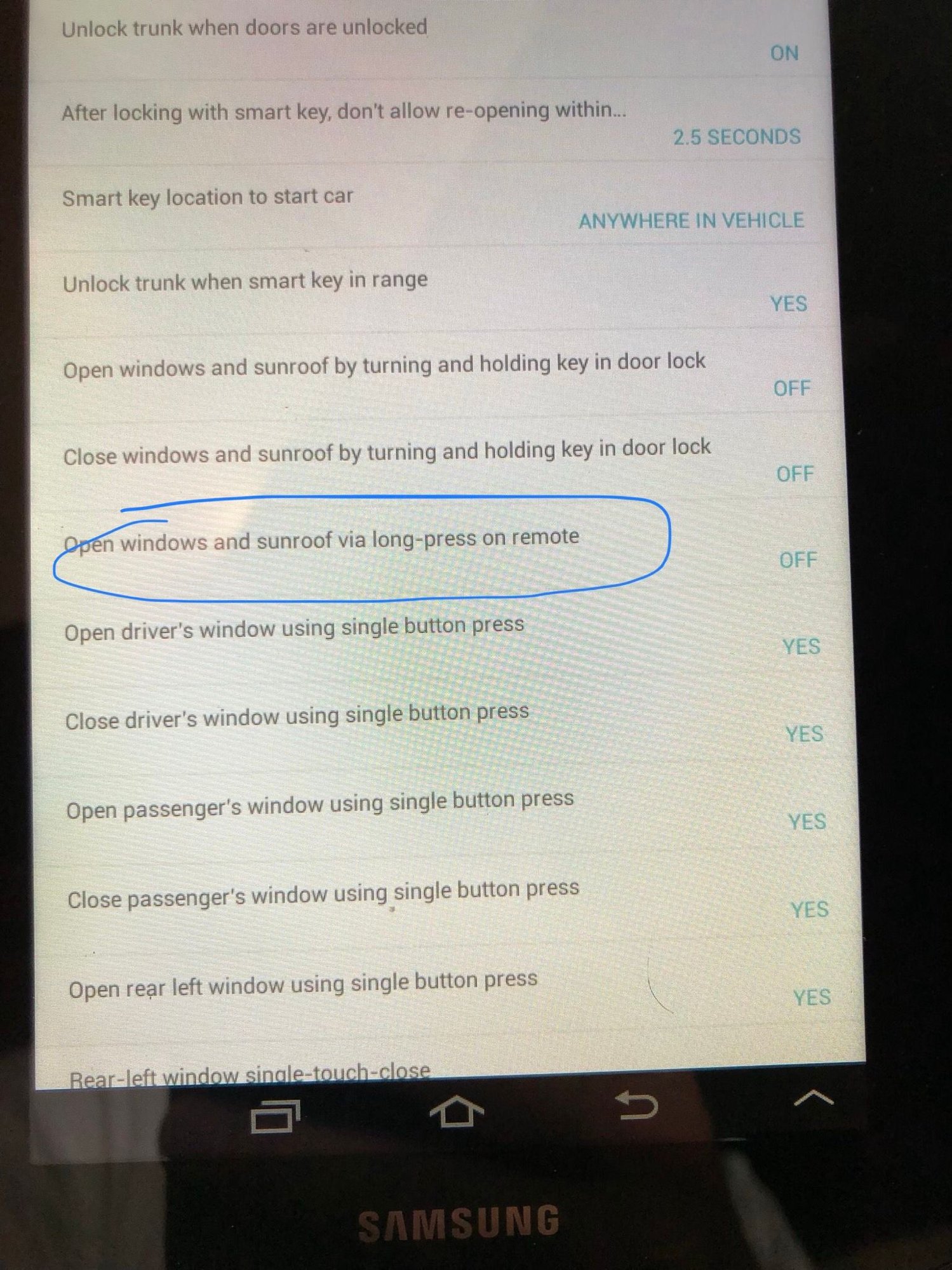

shouldn't cost anything. it'll take them less than 5 minutes to do it. you could do it yourself with the Carista app. Have to have an OBD2 tool as well though. ($20 from Amazon).

I circled the option. Very easy to change.

Are you using the app in this photo?
