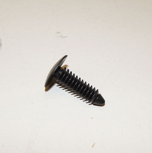

Next question, how do you get the retaining pin/clips out? They look like they have a pry slot and I tried with a screw driver but I was pretty sure I was going to pop the head off before it turned loose of the hole it was in, It doesn't appear to be the two-piece push-pin type that are used under the hood. I guess I can get some spares and just pull on it until it gives.

Yeah I destroyed those clips when I popped mine off on the GS. Just go to a Toyota dealer and buy a similar looking clips and replace those suckas!
Use a trim clip remover tool and wiggle it left and right, never use a screw driver. They are pretty robust. It's the christmas-tree type clip if I remember correrctly.

Yes it is the Christmas tree clip for the trunk liner.

Nope, no extra holes on a 2013 GS. I can probably drill some but there aren't any additional ones that will fit. And the pins are this type, no tool will make them easy to extract. Just jab a screwdriver in there and pull.
http://assets.suredone.com/1704/medi...n-qty-20-4.jpg
