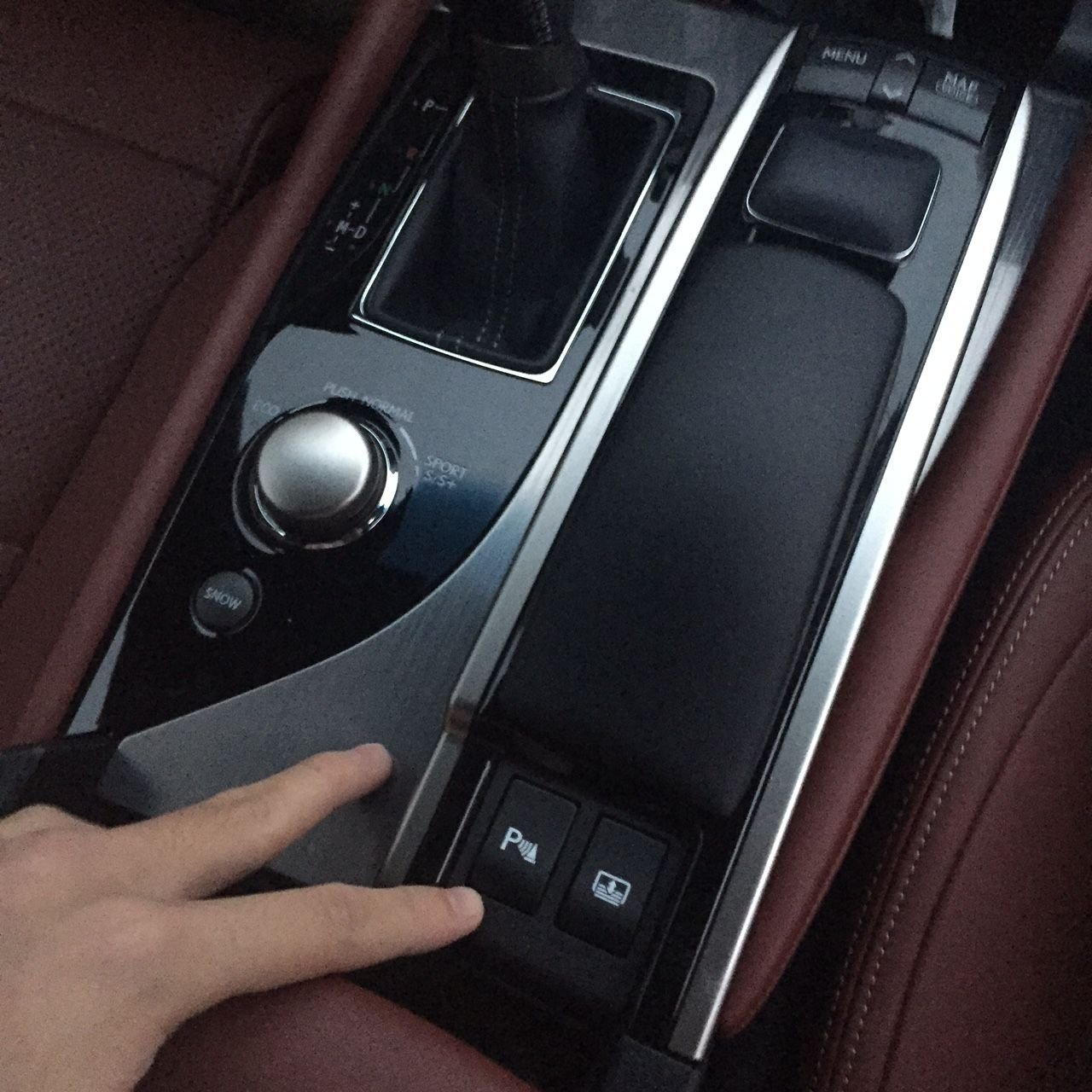

Do you mind telling me how to remove seat cooling trim and cup holder lid trim? I was wrapping my interiors too and couldn't figure out how to remove these two pieces. I mean how to remove the aluminum trim. I already know how to remove those panels.

I sent @peasodos one of my extra cooling buttons I got from a GSF and since my GS350 already had them. You just take a flat head screw driver and push the little tabs out. It's annoying because they are small and clip back in when trying to remove the next one. I kept one screwdriver in one side and used another to remove the others, this way it stopped the others from snapping back in. Not difficult, just a bit annoying. lol
