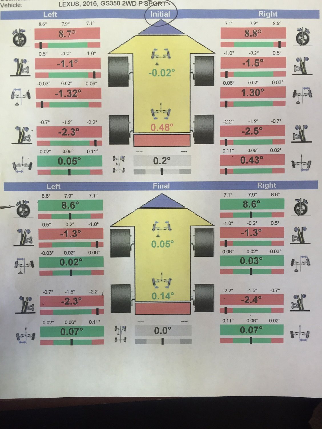

Thought I would share this with fellow GS owners.
1500 miles after I dropped it and put 20's... Drop is about 2'. I know I probably took too long for the alignment.
