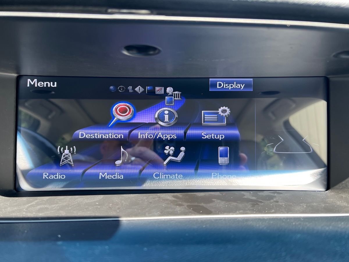

Factory menu normal view:

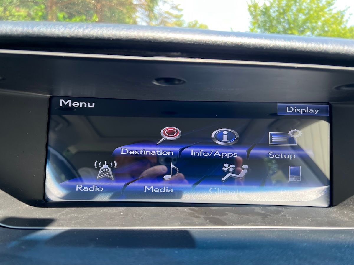

factory menu "stretch" option

Thanks, I will update as I go, the lack of the right menu is def something to consider, I believe the option that would best keep the factory setup working exactly would be the upgrade kit, it would also keep the stock screen (less resolution for sure, but also less glare).
Speaking of glare, yes. Having driven it a bit more today in the daylight hours, I can see that the refections specifically are far more. I don't think it is a deal breaker for me, but I will looking into anti-glare strategies, I am guessing there must be some good ones out there. I did a quick search and saw discussion on Nushield Triple A, any suggestions?

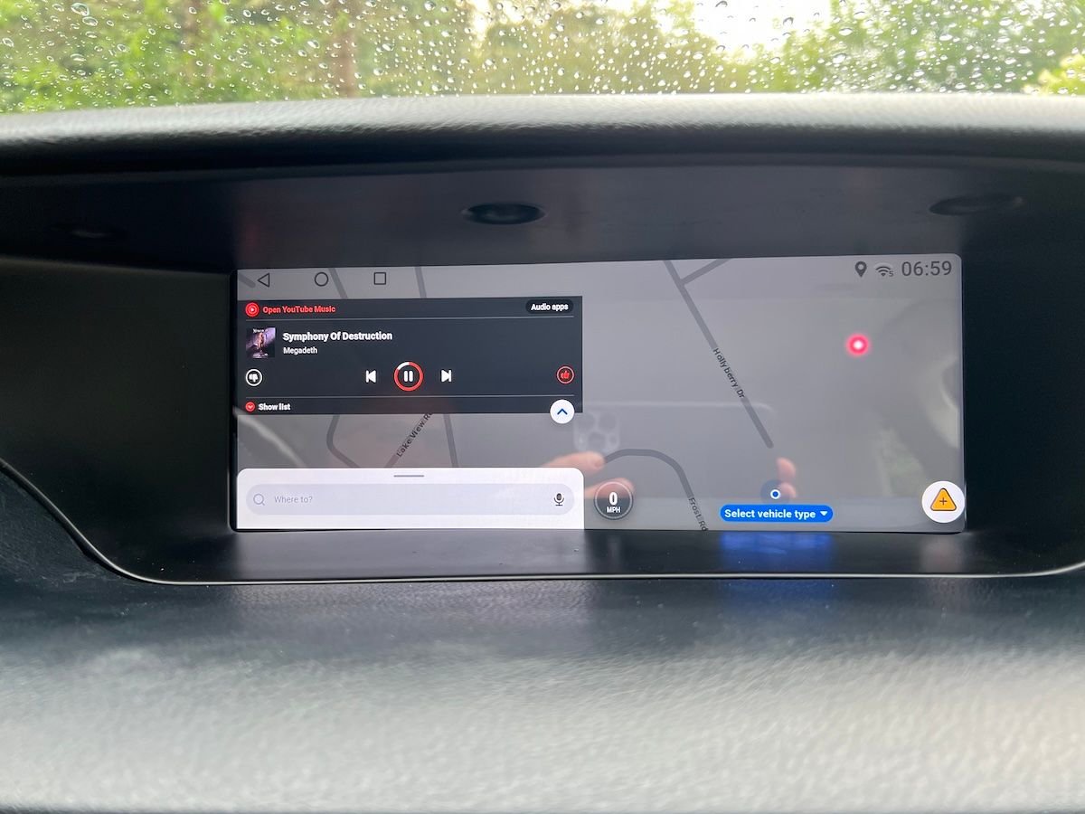

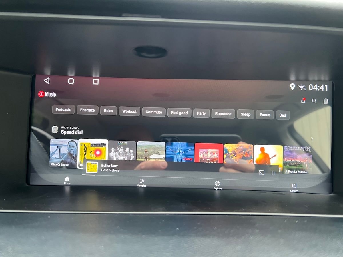

Here are some images of getting the music and nav apps setup directly in the Hamilton / Android OS, I also got the 3 plastic screws back in the screen bezel. They were right in the video, you really need to press up on them, more then you expect given they are plastic.
Here is Waze with the audio from my YouTube Music in it (probably the main way i would leave it driving)
Here is YouTube music:
Again just to be clear, these are not with CarPlay open, they are running directly on the Hamilton screen in the car, my phone would only be used for data tether if needed.. But I am hoping with downloaded maps (google maps) and downloaded playlists I might not even need the tether.
