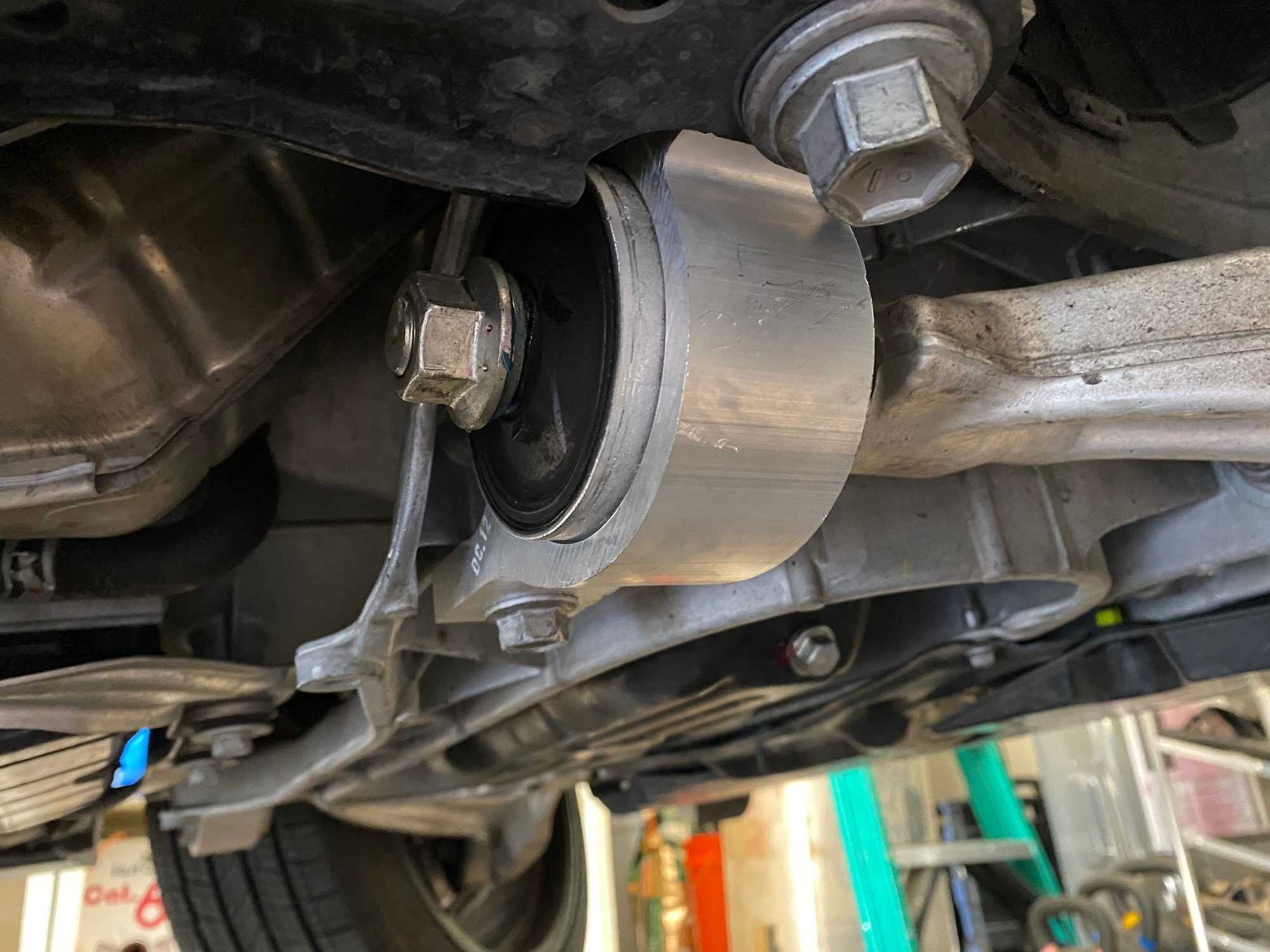

@GS350PHX An installation video would be great! Also, how would I load the suspension? Also, do you happen to have a part number? I found two part numbers, 48075-24010 and 48076-24010, but I'm not sure what the difference is between them except that one is labeled No. 1 and the other is labeled No. 2.
How many LCA bushings are there on the GS350? Is it two in the front and two in the rear?
Also, here's a picture of what the dealership sent to me:
Do you think that's what they're referring to as the caster bushing?

Yes you are showing the rear LCA bushing. And yes, there are two part numbers (one for left and one for right). Your numbers look right to me.
