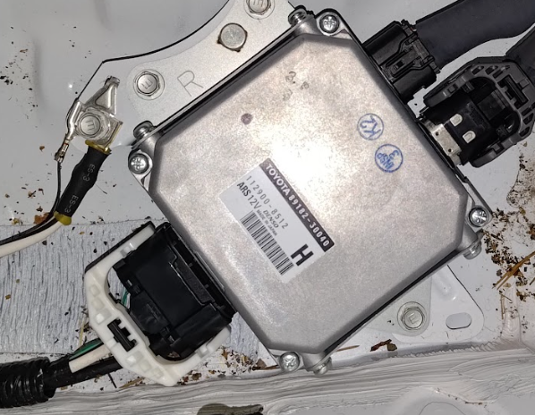

Sorry, I made mistake on my post #39. Don't know how I got wrong link, but at least the price was same $134.99 . So, let me try a again, this is the rear steering control ECU which was in the same car I purchased the ARS. It is 89182-30030 (112900-8502) and my own car have 89182-30040 (112900-8512). There might be minor difference but I checked from several dealers selling new part using my VIN and 89182-30030 does not fit.
This is from my car:
For the ECU, I don't really think it is the problem, my suggestion is to install the ARS unit first and see if you need an ECU or not.
Unless you get a really cheap ECU like less than 300$ then don't miss the deal, otherwise the cheapest option is to install the ARS and see what happens afterwards.
This is exactly my plan. All the evidence indicates that only ARS unit needs to be replaced, not ECU. When I say all the evidence I mean those two cases in UK and one other in Finland I have explained earlier. Problem seems to be failed stroke sensor.
If I could find 89182-30040 with reasonable price, I would definitely buy it. Just in case. Let say under $300.
That listing on ebay shows it's returnable if you need to.
Yes, this is true. However, sellers do not deliver outside USA, to Finland. So I need to use proxy service. Proxy gives me address in USA. To deliver ARS from USA to Finland thru proxy including shipping will cost around $150. Honestly, I'm not sure if it can be returned from Finland and I would guess returning will cost same as sending it to Finland. If the part won't fit might be easier to sell it myself here in Europe.
