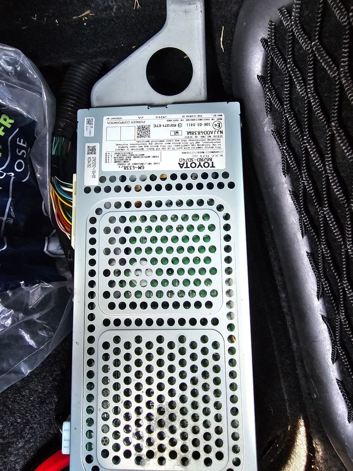

So I’m sure a lot of you guys have been through this already but I couldn’t find the thread after searching a couple of hours. My factory amp went on me out of nowhere and I don’t want to pay the 600 plus dollars to get it fixed. Are there any suggestions to an aftermarket amp I can buy instead? I’m riding in a 4gen gs350 with navigation. I already contacted clutchfield and they need the wattage for my current factory amp. I know it’s running at 4 ohms mostly and 1 2.5 ohms speaker and has a 13.2 voltage. May sound redundant but I appreciate the help in advance.

it’s the pioneer one but I’m posting a picture

My bad, I misread your post and I thought said ML.
Old Jul 31, 2024 | 07:30 PM
tammap's Avatar
tammap
Joined: May 2007
Posts: 811
Likes: 361
According to this vendor, it's 600 W unit.

Old Aug 6, 2024 | 12:46 PM
DaSyce's Avatar
DaSyce
Joined: May 2007
Posts: 820
Likes: 26
The 12 speaker premium sound system uses 4 passive crossover (high pass filter). It’s really a 20wx7 = 140w (4ohm) + 60w sub (2-ohm). 200w total output.
