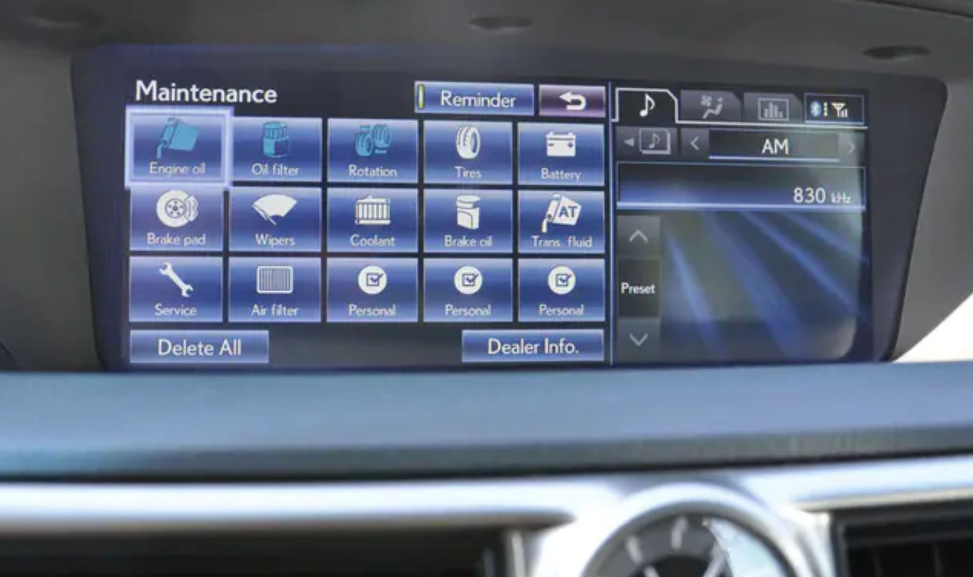

Originally Posted by JeffKeryk
Maintenance Reminder. Second row last to right.

Those are just standard maintenance reminders common from years ago that some carmakers still provide on newer vehicles for customer convenience... It doesn't mean any of the reminders are actually needed unless it is recommended by the carmaker in the Owners Manual...

Thiugh. The same engine, trans, and fluid in the 3rd Gen Gs Lexus said change the trans fluid.
