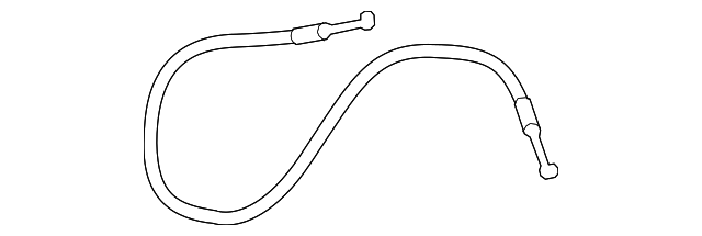

The latch motor is actually referred to as a 'Lock Actuator' but there are two of them shown in the image below, both with the same part number - it is used with a full-fledged 'Power Trunk Closing System': P/N 64650-30070.
My guess is, the problem is most likely (hopefully) with one of the inexpensive and easily replaced $40 'Lock Cable'; such as P/N: 64607-30220 (See image shown below)

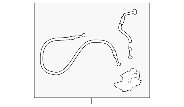

The image below might be helpful to get a vague idea of the cabling used even though this image doesn't specifically show the above part numbers.
