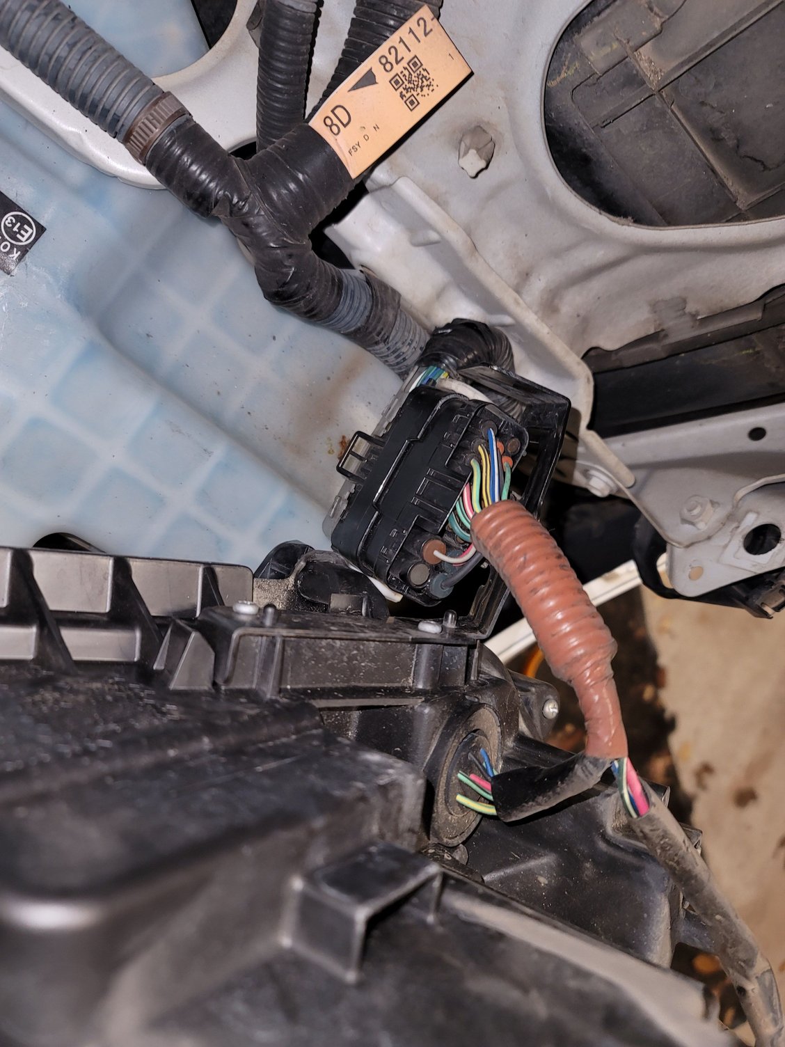

Default Help! How do I remove this headlamp connector?
@JoshIS408 or anyone else, how do I remove this connection from the headlamp? I'm trying to complete the headlight conversion.

Spray silicone lubricant where the plugs meet, then push down on the tab that is above the wires and pull out at the same time. Use a flat head screwdriver gently to pry them apart while you are push the tab down
