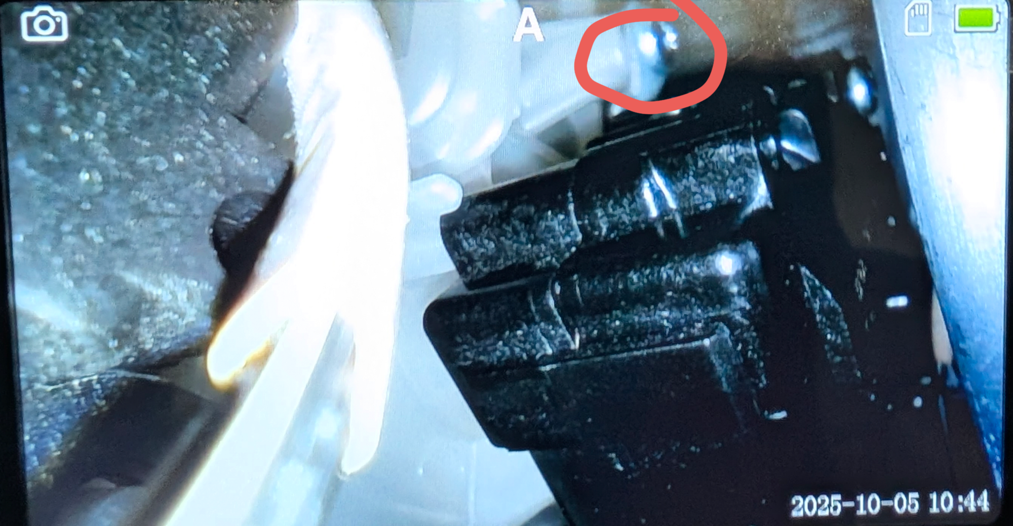

Took a stab. No real success other than skinning my finger
In my case, I was trying to remove the "Cool A/M Servo (P)". This the the servo that moved when commanding the passenger cool air mix. It almost seems like the door is getting jammed since you can feel the servo almost flex trying to reach a lower value (in Actuation testing). Below is a look with the glovebox removed:
You can remove the connector with some long needle nose and a small flat head to pry. Then you can slowly loosen the screw circled in green with a right angle ratcheting screwdriver. Watch out for the ground crimp in red. It's sharp enough to skin you hand
Looking at page 55 of 77 of the TSB, you can see the servo has two screws that need removal. The one above and another that I can't currently reach.
I'll poke at it more later...
I wish there was a way to remove the blower unit as that is fully in the way.
You're almost there, the blower housing is held by three 10mm nuts/bolts. Undo a few plugs and you'll gain better access to the servos

Well I like to struggle, so I went ahead and tried to take off the cool air/mix passenger side servo for B1454 error code. I was able to do it without removing the blower unit, just to see if it could be done. But if I have to do it again, I'll try taking off to compare effort.
I basically followed the steps in the IS dealer video. You remove the glove box and lower knee pad airbag panel. You also remove the black foot vent (held by a Philips) and unplug and move out of the way the AC amplifier (also held by a single black Philips). Also unplug the two thick wire gauge (creme and black) plugs.
I had initially struggled with the harbor freight right angle screw driver. I got this with more teeth and less backdrag since you don't have much room to turn.
Amazon Amazon
Also, I used the 1" and 2" Philips from here:
Amazon Amazon
It doesn't have to be that set, just something that has a 1" and 2" bit. The DeWalt bit set I have only has 1" and 2.5", which is too long. It'll be easier if you cut down one of the 2" bits, like this, so it's the perfect size.
Lastly, I also used one of those snake cameras to help guide for the back screw.
Either way, I popped open the servo (just some tabs). There weren't any missing teeth as I thought there might be. I took out the wiring pin and potentiometer assembly and took off the cover (4 flexible metal legs). I cleaned with with parts cleaner.
I put the potentiometer back together, and added lithium grease to the gears and pin points.
I put it back together and back in the car and did an initialization. And... still and error initially. It was still getting stuck.
What eventually got it going was setting passenger temp high, then doing an initialization. Then setting temp around 72, and doing another initialization. Then setting temp to LO and doing another initialization. You check the values between initializations, as you change the temp. Say you set a temp, and you see the "command" at 158, but the actually value only goes down to 192. So you'd leave it at that temp, then do an initialization. Repeat as needed.
Eventually, it was able to do all the range. I do the a new part coming in over the weekend, but I'll go with this one until it breaks. I'll have to take out and clean/regrease others when I have time as I'm getting other intermittent errors, like rear servo (B1449), B1443, B1446, B1442.
