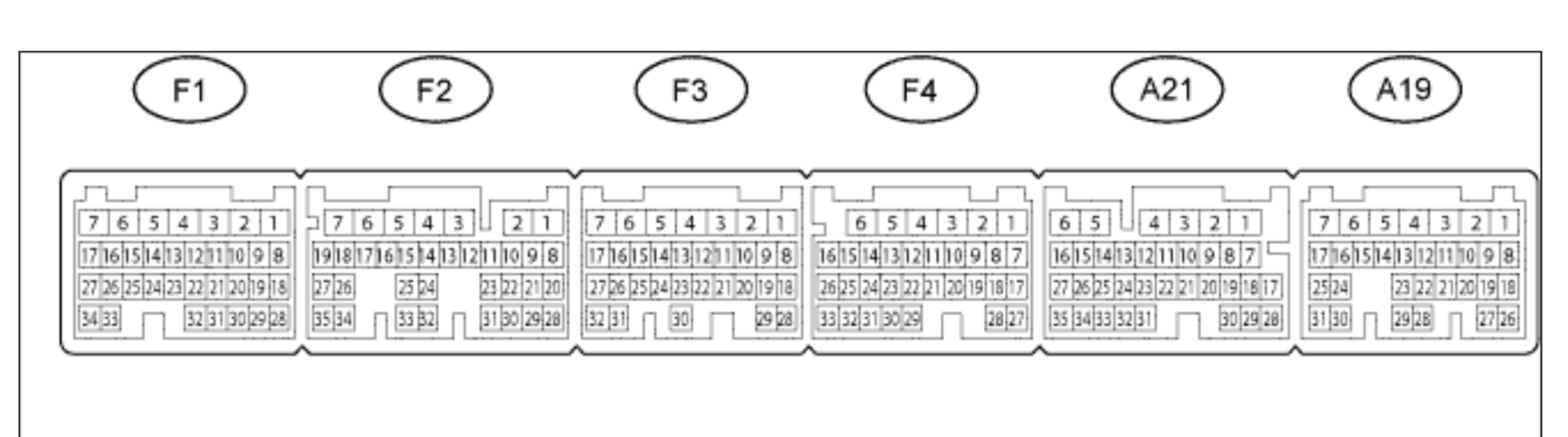

P0023 appears to relate to the crankshaft timing control valve for bank 2, seemingly for the exhaust side. It is on the driver side.
On the ECM side, look at connector F3, pins 18 and 28. Those connect with the crankshaft timing oil control valve.
P0441 code is potentially related to the purge vsv, also on driver side.
Check the electrical connectors for both.
On the ECM side, connector F1 pin 17 connects with pin 2 of the purge vsv connector.
ECM connectors
ECM connectors
Wow, this is incredibly well-explained and thorough. I can't thank you enough for taking the time to assist me. Your help means a lot! Initially, I mistook the last picture with F1-A19 as fuses, but now I understand they are actually the pins on the cable. It's crazy to see and learn about. With this knowledge, I have a better idea of what to look for. Hopefully, this will help fix the cruise control issue. I believe I may have accidentally loosened or damaged a cable somewhere.
