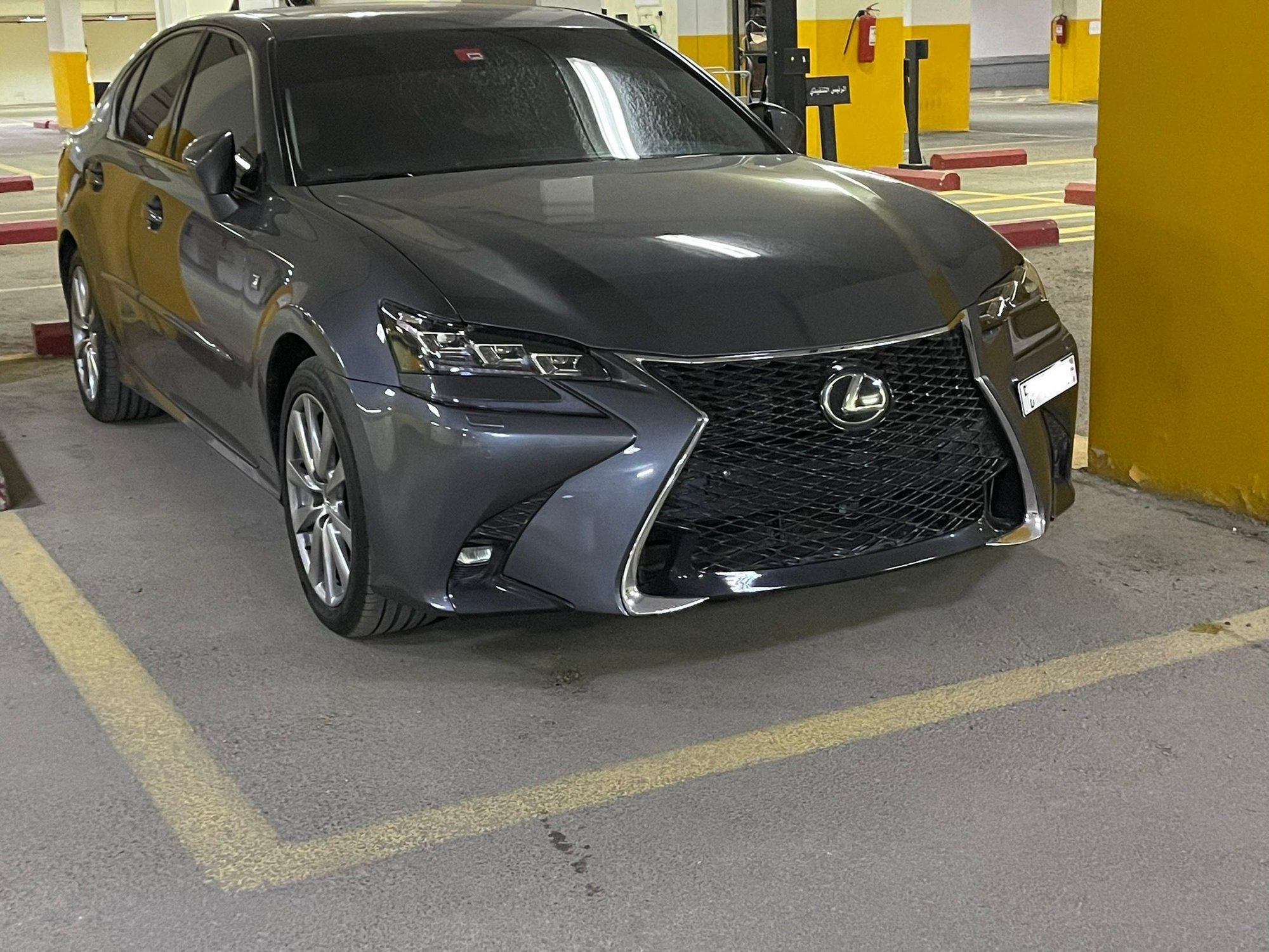

I have 2014 GS 350 USA spec and i have installed aftermarket headlights and bumper and the car is upgraded to 2016 model.
so my car looks nice and better and you see in the picture below.
but I’m still getting this error in the dashboard “Check Headlight Leveling System”
is there any one facing the same issue? And how to fix it.

This can be attributed to the aftermarket triple beam HL installed.
There are several threads on the topic.
Which ones did you buy?
Post link and others that went this rout can point you in right direction.
Your ride looks beautiful !
