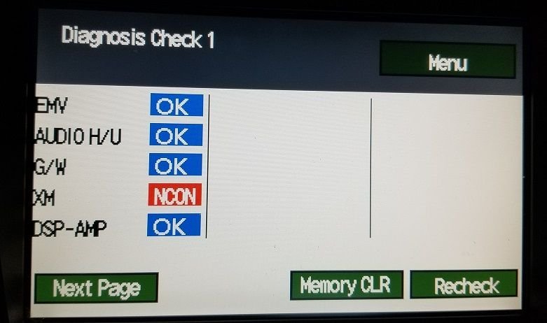

Using Jumper wire or equivalent, connect terminals TC and CG at the DL3 connector for at least 30 seconds. Do not cycle the ignition switch to “OFF” position during this step. (Landcruiser use TC and E1 at DLC1)
Once 30 seconds have passed, with the vehicle still in “IG-ON” mode, remove the jumper wire, then connect TIS Techstream and begin the registration process.
I still have a few days to try and get this squared away.

After the jumper was installed this screen popped up (along with pretty much every light on the dash):
Cable check utility in Techstream not showing K, and L lines (which I assume is why it's not working).
