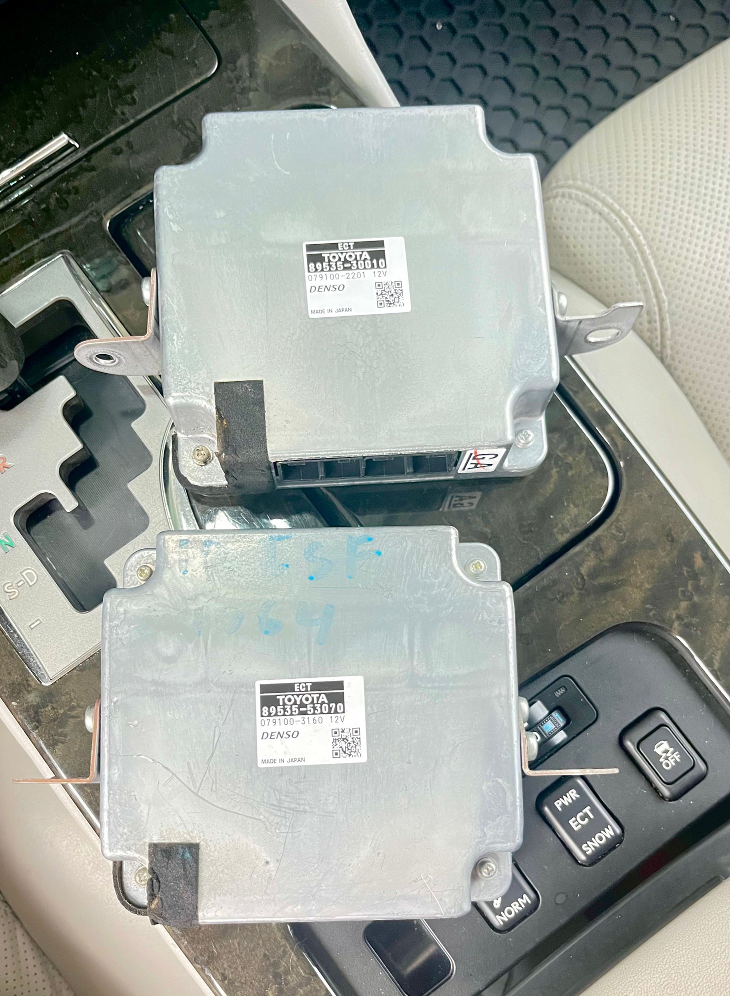

Originally Posted by beez43
Does this only apply to 460’s? This is very interesting. My 07 350 is supercharged im at about 380whp.. looking for further upgrades to enhance the performance and will retune. Unfortunately i went the mapecu3 route but this was before any info on the ecu being cracked. Thanks in asvance.
Only the 460 since they share the 8 speed AA80E tranny with the ISF. The connectors are identical. ISF module on the right in the pic.

Default I have in isf tcu in my gs460
Originally Posted by Oceans13
Simply plug and play, the car does the rest. Post pics of your 460!
i need help, i have installed isf tcu into my gs460, but the problem is it doesn’t rev mach and it doesn’t bounce in the gears.
can you guys help me
It wont, unfortunately this is a big misconception of this mod.The SPDS logic (rev match downshift, and lockout) is in the ecu, not the tcu.
The biggest difference is the shift speed when in "manual mode" using the ISF tcu.
