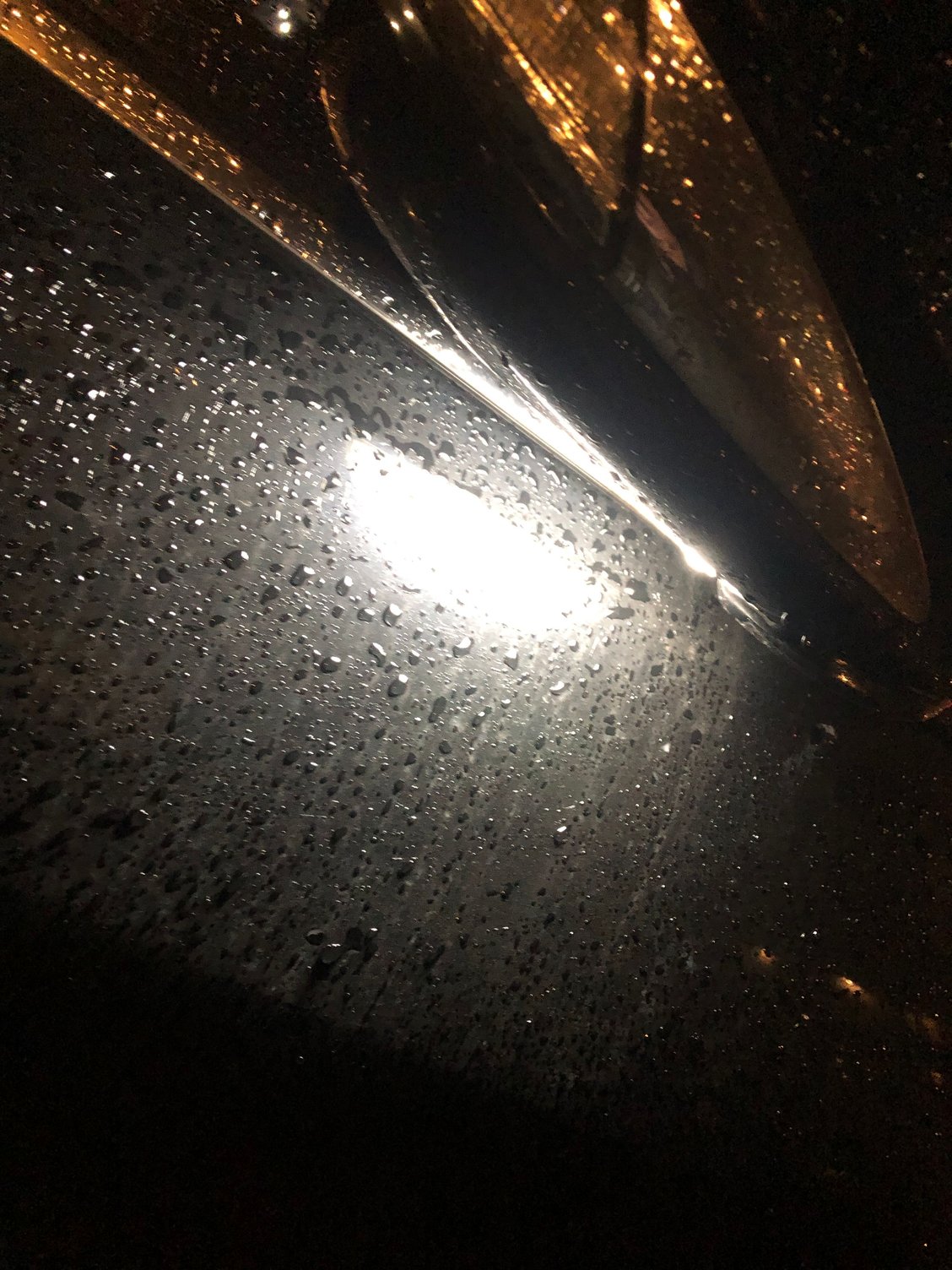

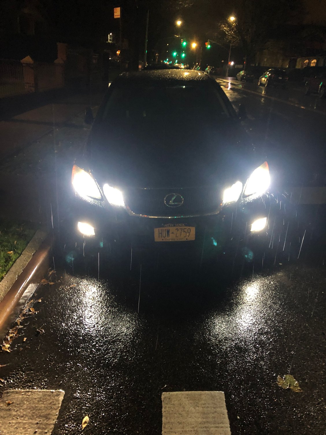

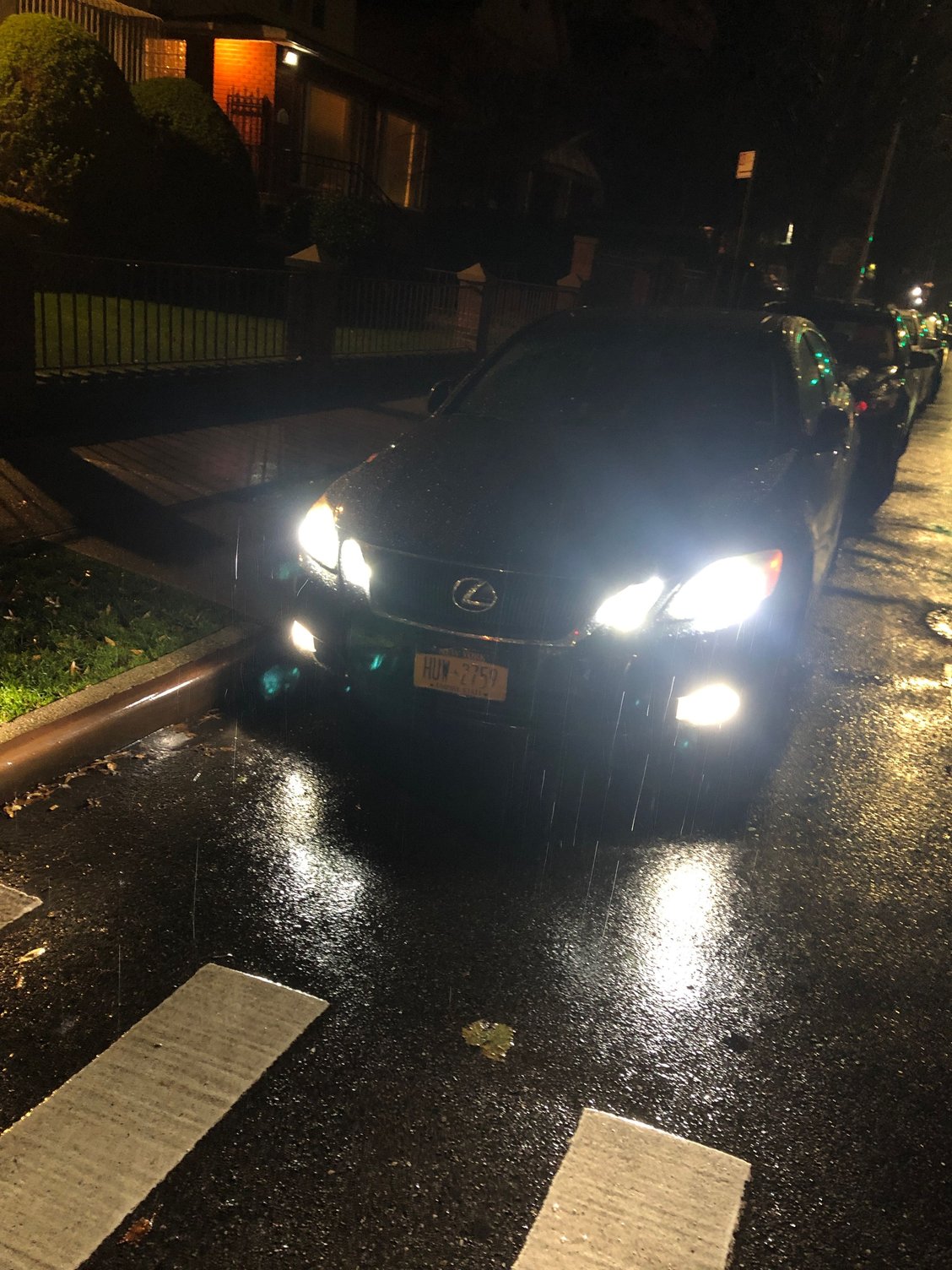

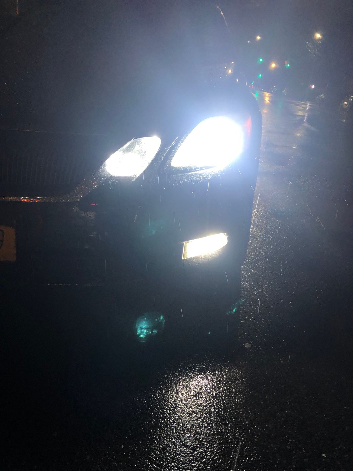

Default Bad pics requested
Camera stinks
Mirror led puddle lights
Old Dec 5, 2020 | 01:48 AM
KH818's Avatar
KH818
Joined: Dec 2020
Posts: 69
Originally Posted by Mrbungle11
Camera stinks
nice headlights man!

I didn't know mirror courtesy lights were replaceable. But I think I would fear breaking the mirror if I try and these aren't crucial.

What we don't see is despite being advertised as 6000K bulbs, the CBIs seem to be more of a 5000K and don't match my LEDs. I didn't take very good pictures but it is -2°C with a strong wind I couldn't stand being outside for long while changing my camera's settings.

the vled led 194 fill ups my whole parking light housing.... and replacing the puddle lights on the Mirrors is super easy it just moving your mirrors all the way down and you see the screw and unscrew them like two-three turns and the bottom of the mirror housing will come lose to install the led bulbs
