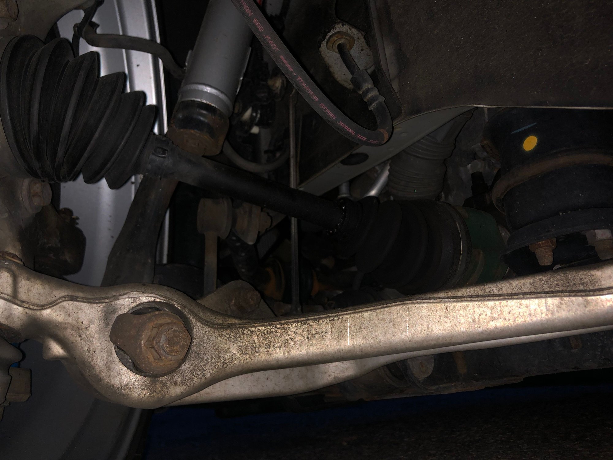

Well if I turn my wheels and take a pic of the axles will that give you an idea of the angle ?
Thats not really something you could tell from looking at it, especially by photo. Gotta put it on the alignment rack.

I figured I’d add pics anyways to see if you notice anything with axels lca is parallel with road
