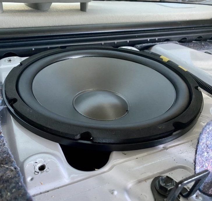

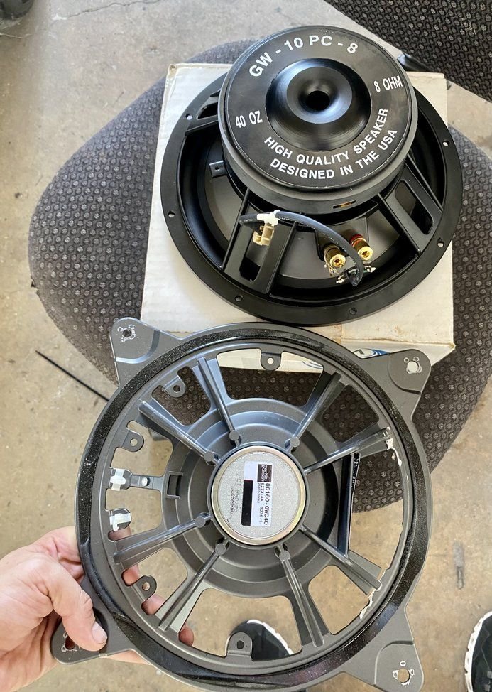

I bought a 2008 GS460 with a blown ML sub. I bought the Goldwood 10" 8ohm and just dropped it in. Been working great for over a year now.
Was shorting out the entire system.
I soldered on the old connectors and transferred over the rubber gasket ring.
Then I just dropped it in. Easy as that.
